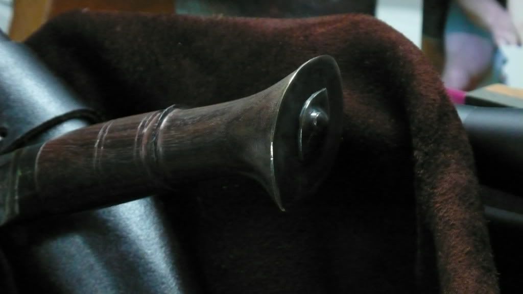

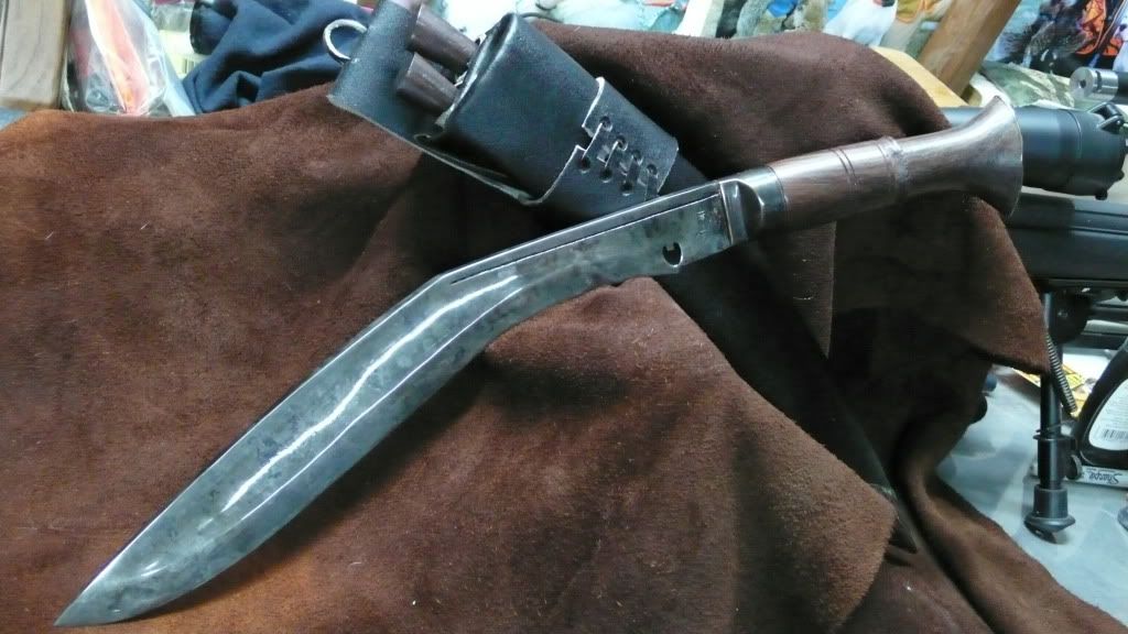

The bronze fittings on this fantastic blade I believe where lightly blackened
This Khukuri has the brass fittings blackened

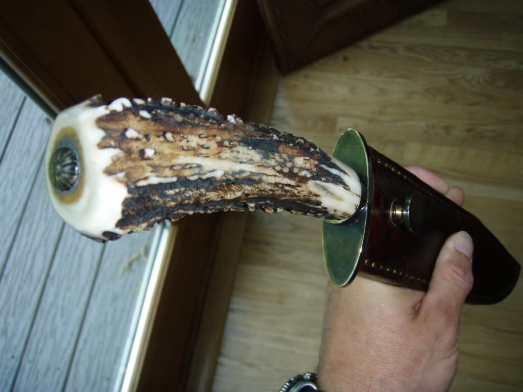

This old Bagwell has a blackened brass guard and frog stud
Thanks Joe, love the finish of the guard on that first blade. Probably the way I will go if I can figure out how to do it.
