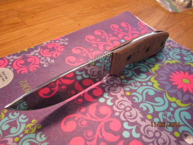

I've polished an Ontario Rat 3, Becker BK2, Spyderco Persistence, and Boker Gnome with a Dremel, 2-inch cotton pad, and green rough. I had to sand and sand and sand with 220-2000 sandpaper first, but it ended up with a mirror finish. Depending on the heat generated with the Dremel there is a chance you could screw something up. I haven't noticed any issue with any of my blades.
It is a lot of work though. Don't think you can get a Dremel and start polishing the blade. It will not work. A lot of sanding is required. Wet sanding, nail-losing, finger-cramping, sailor-swearing, work. The harder the steel the harder the job. The 1095 BK2 and Rat were 100x more difficult than the 8cr13mov Persistence and 12c27 Boker.
All that said, do it. It is very rewarding and adds a free mirror to your EDC. :D

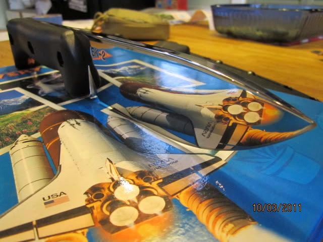

The BK2 was the most difficult. It was the first. I sanded and sanded and it still looked terrible. The coating on the BK's is to hide the deep grind marks. If you are anal like me, you will need to get them out. It requires a course grit which adds to the total work. I used a Mouse sander with a 60 or 80 grit pad. It took forever to do. When it was done I felt like I climbed Mt. Everest.
Buy a bunch of sand paper. Wet/Dry variety so you can wet sand. The auto-parts store will have the high grit (1500-2000) paper. 800 or 1000 will not be good enough. Also, check out Sears for green rouge. Don't bother with the red stuff Dremel has. The green is the stuff. Also check eBay for 2 inch cotton polishing pads. Don't use the Dremel supplied pads. You want a large diameter and cotton. I don't know if I'd go above 2 inch since it may generate unbalance and wobble.
The rouge will leave behind a black residue. This will wipe off with a cotton towel. Do little areas and keep the heat to a minimum.
