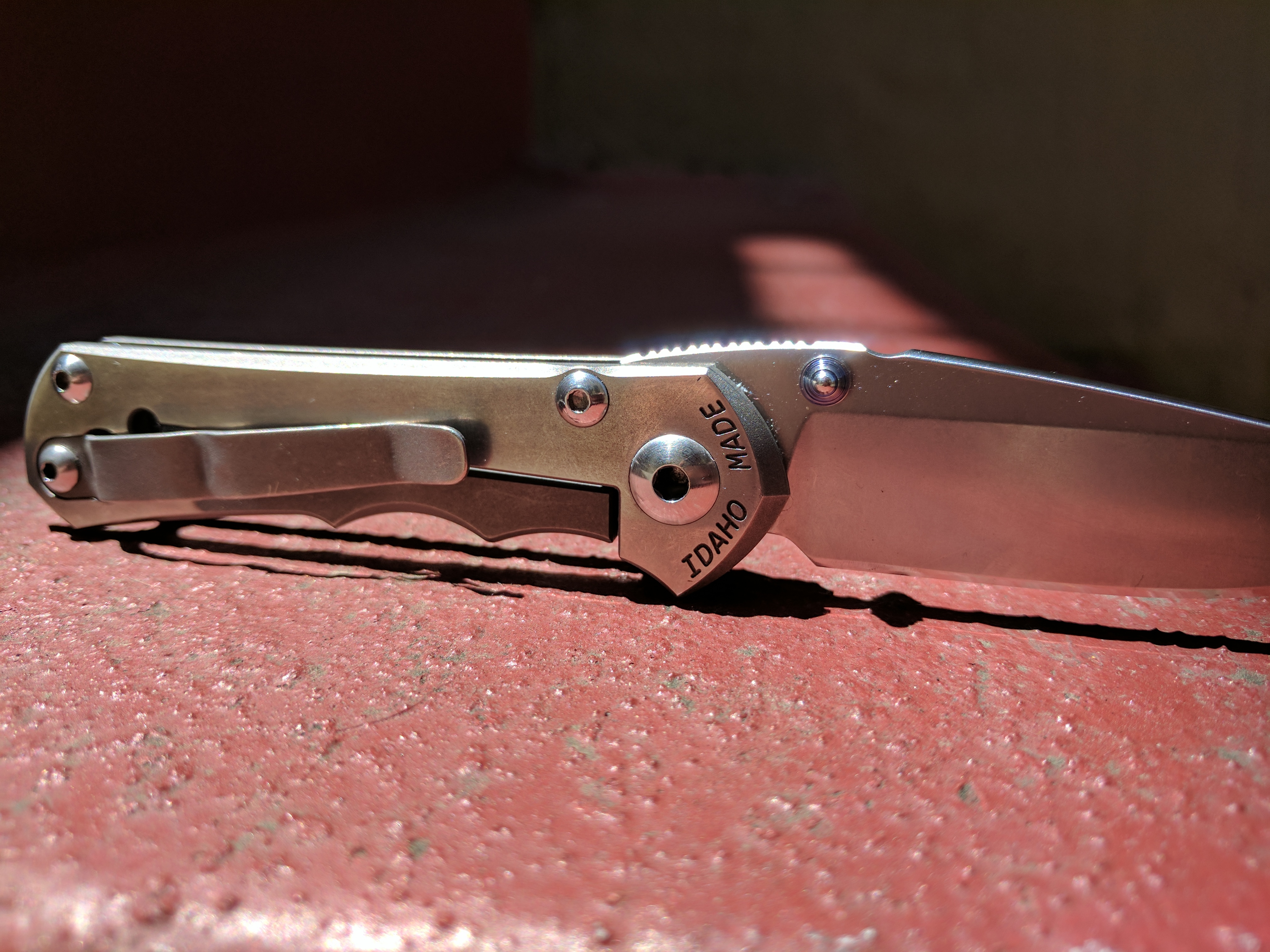

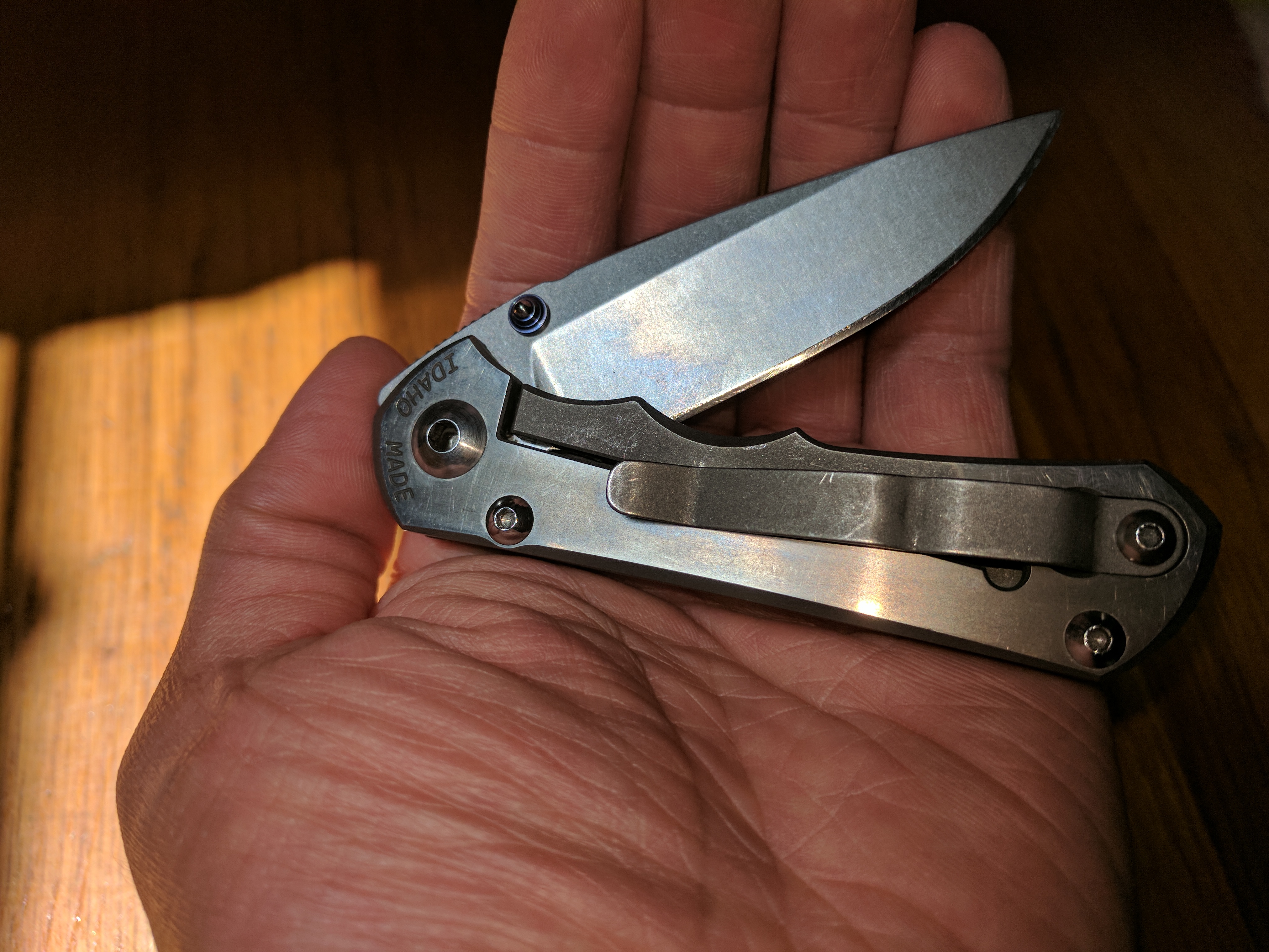

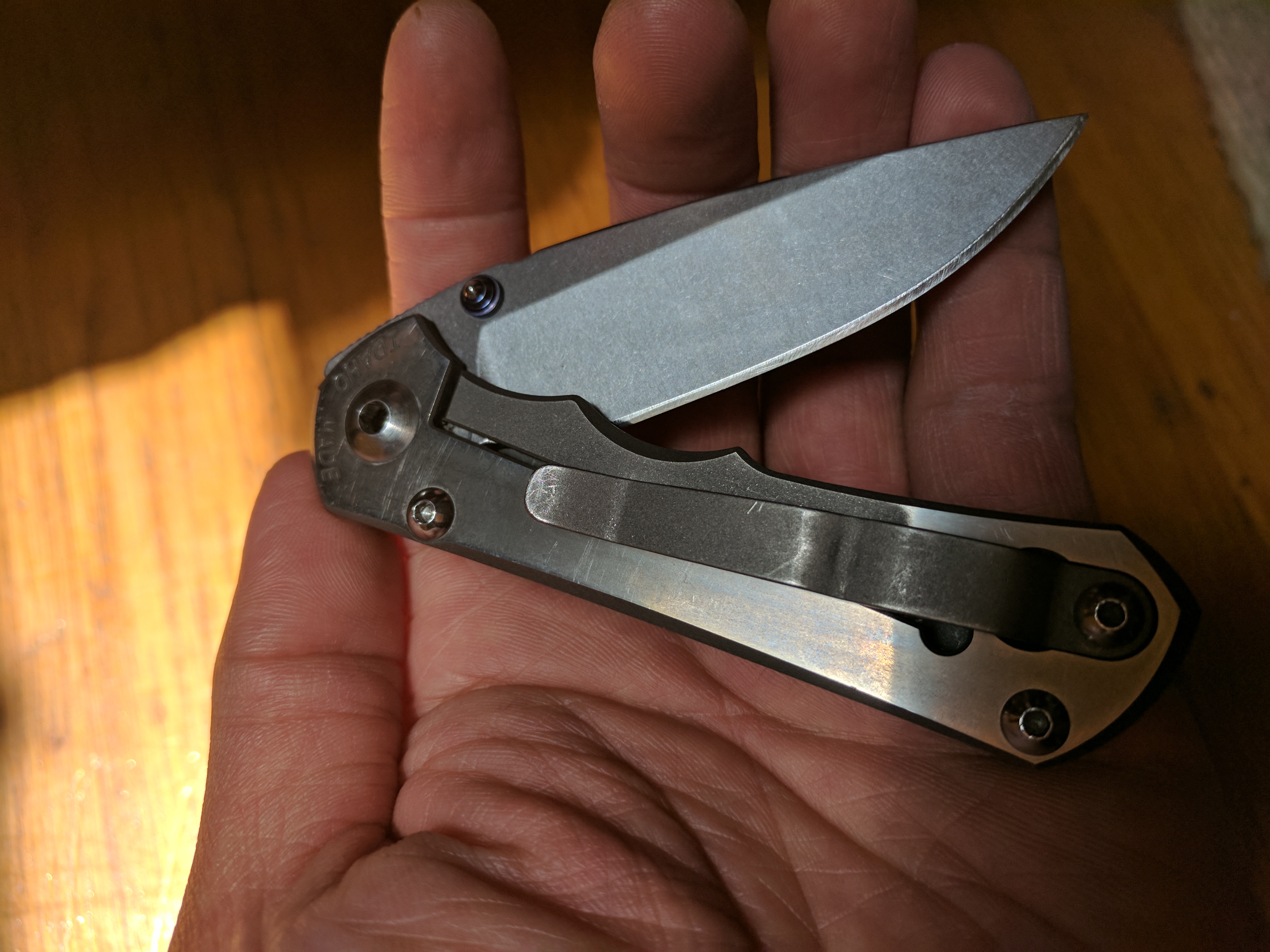

I find it interesting the ones with the forced polish (like mine) have a bright halo around each fastener. The ones that have weathered over time in someone's pocket have the original bead blast around the hole and are still the original finish. I understand it's because the sandpaper finds the edges of holes first and shines up the edges first. Kind of a cool effect...
