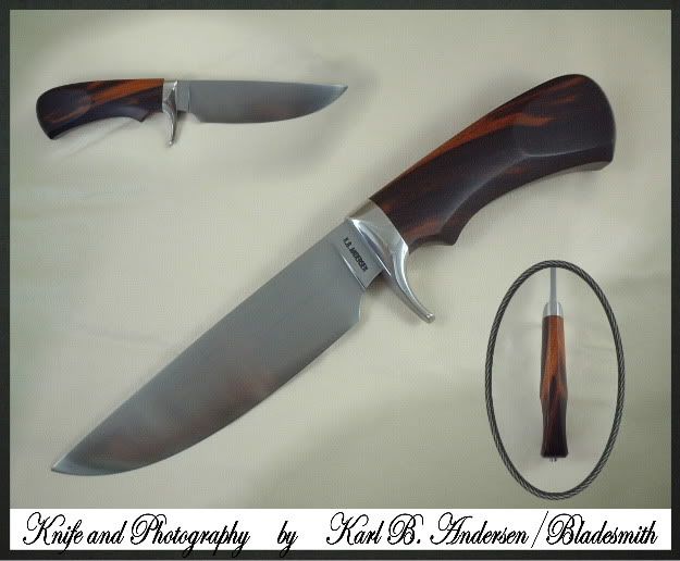

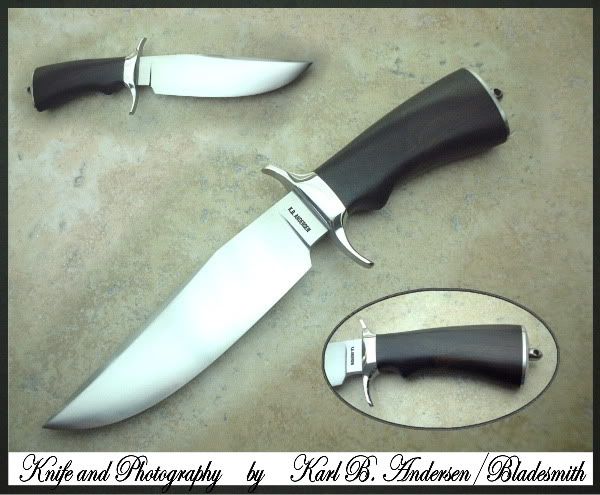

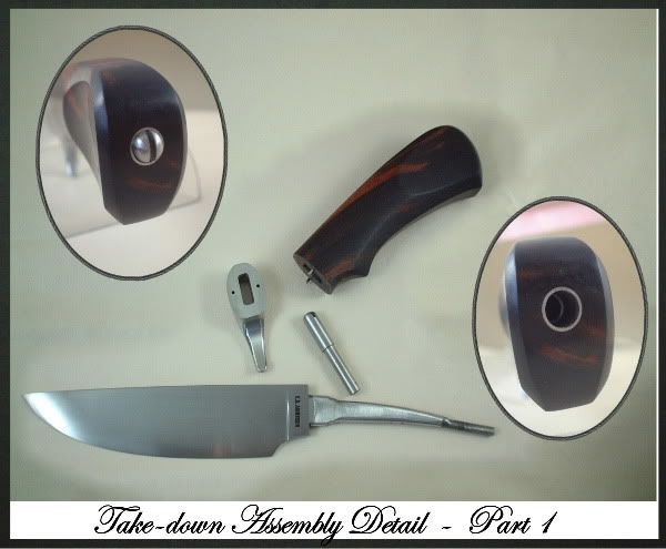

Here are some ideas for you. Also, check the link at the end and click on the pics for larger ones.
http://www.andersenforge.com/knifeconstruction.html
