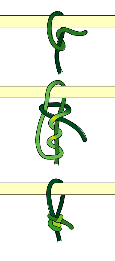

here are the basic knots (hitches) used- if I can do them- believe me anyone can :D
tautline
You might consider an adjustable grip hitch instead... I think it grips better (especially on wet cordage) but doesn't bind as much, so it's easier to untie. I also think it's easier to tie in the first place as well. YMMV.
+1 on the adjustable grip hitch.
