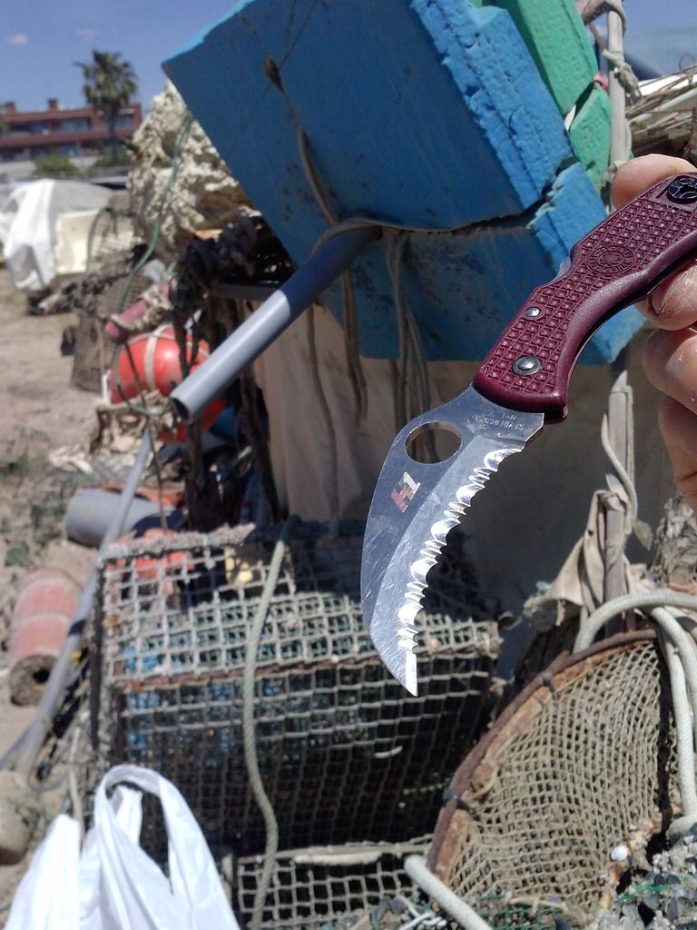

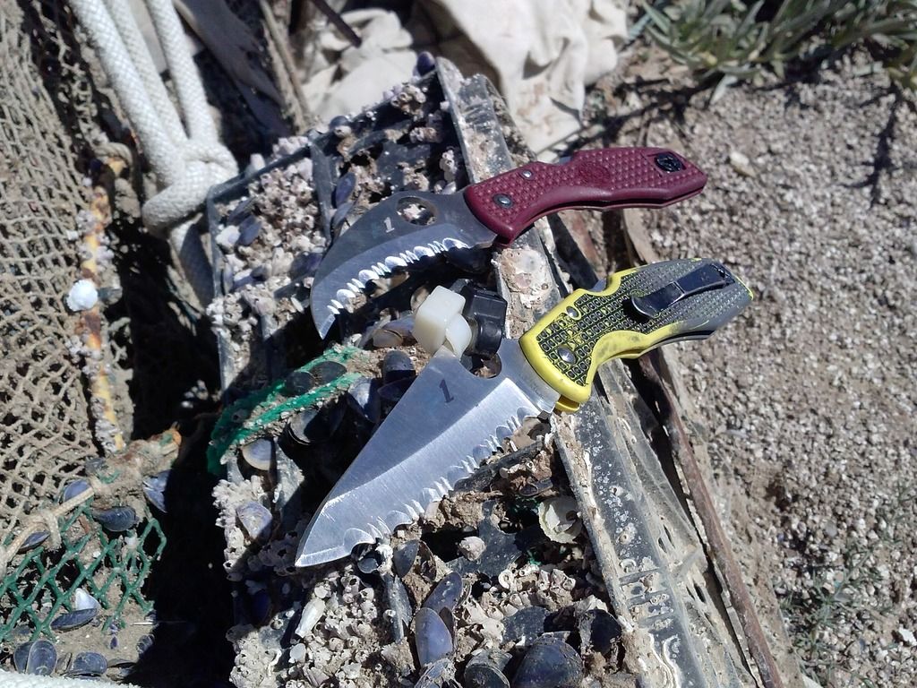

Pictures speak louder than words ;
Fine work use the Dragonfly , harder outdoor tasks use the Tasman.
