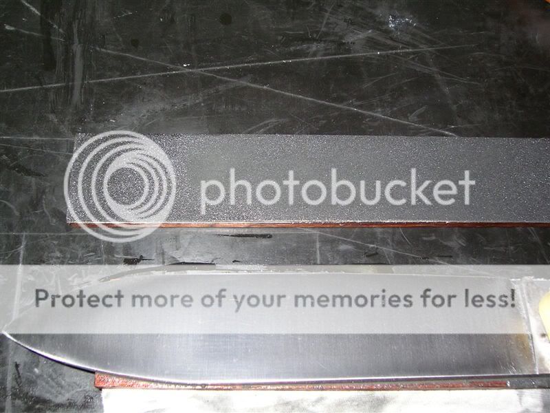

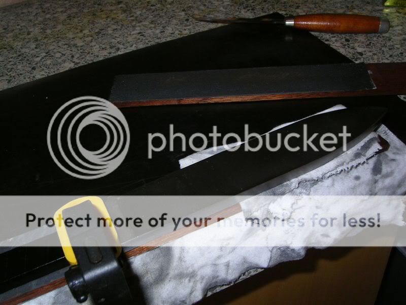

How about this one?
Not finished.
Only worked the blade with grit 120 sanding paper.
Made from 5/16" stock blade is 8";)
Safe Queen????:D
Cheers,
André

by the way,,,what type of steel is that you are working with:confused:
The steel is from a Cold Steel Trailmaster blank Carbon V 5/16" thick.
I plan on going to grit 1200 with the satin finish.

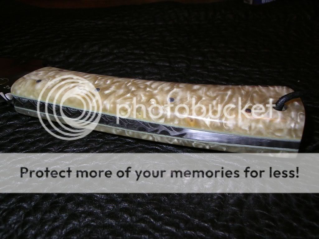

The handle will be made of Musk-Ox horn from Greenland. This is how it looks like.
Might do some slaps of Musk-Ox horn on a real Busse knife with some nice musaik pins:D :p

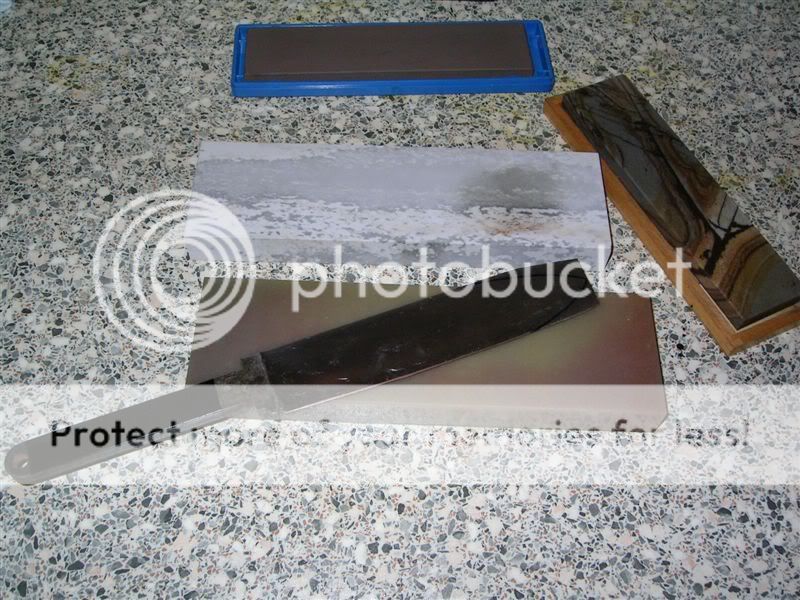

Man those are some beautiful stones in the first picture Andre! Looks like an Arkansas translucent, a white and the top one...a surgical black maybe, don't have a clue what the other one is with all the colors in it, dang thing almost looks like some type of marble or polished granite.

The stones are soft Arkensas (white stone) The damaskus style stone is a very fine natural stone: do not know what kind maybe black Arkensas.
The stone the blank is laying on is a rare pink translucent Arkensas stone, that stone is super fine but removes steel very well to.
