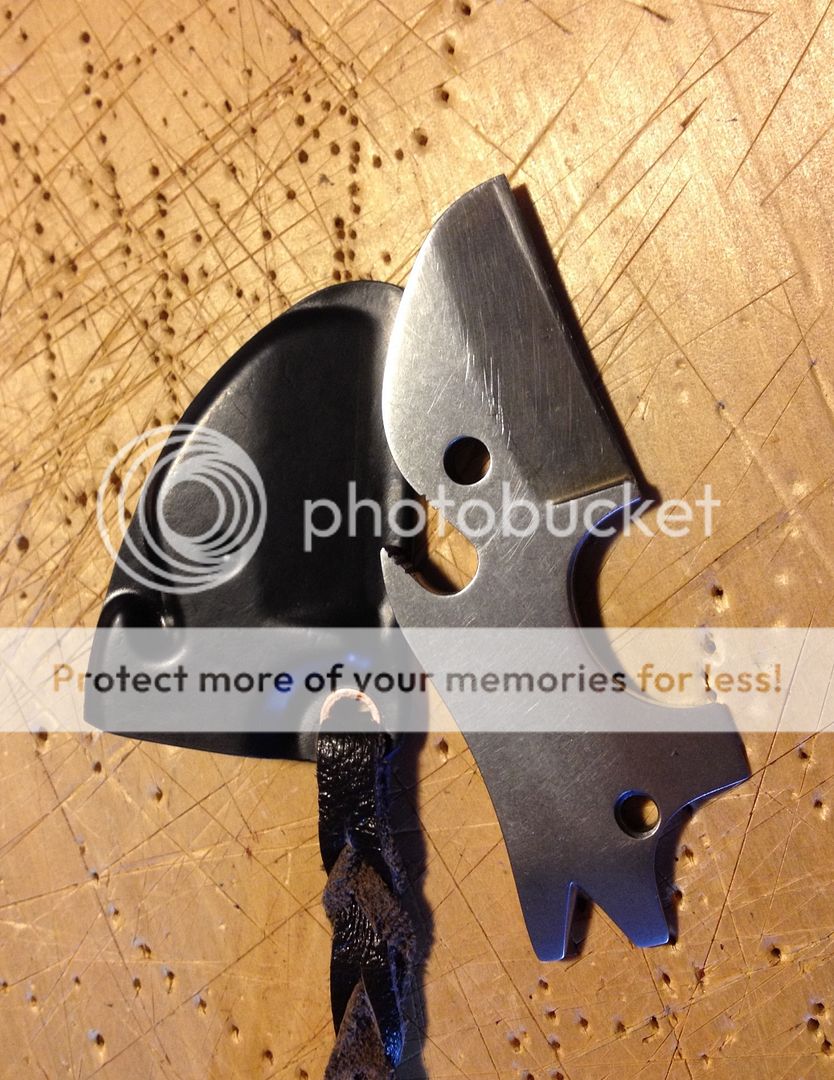

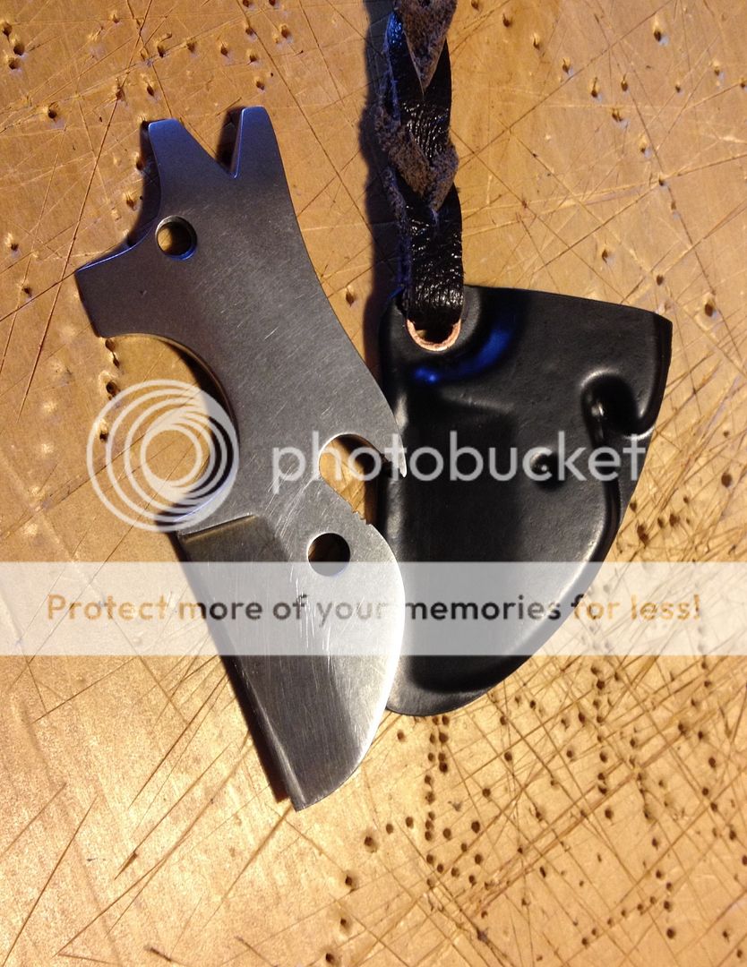

There is a world wide diary system called "Day Timers" but I am sure there are many generic versions. The Day Timers comes with a black plastic page divider which I have used as a sheath/holder material.
It is very forgiving and you can go again if you stuff it up the first time - I just used a heat gun ( the sort you would use as a paint stripper) to heat it. but an oven would work.
Possibly a 'Office Supply' shop in your area would have something similar sold as a single item rather than buying a whole Diary
