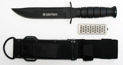

I just remembered I have a small sharpener that came with one of my knives..
How do I use such a small thing though ?
Anyone have a video of someone using such a small tool ?
[pic]
With pocket stones, I basically hold the blade down and work the stone over the edge, kinda like you would with a file. Same process as most sharpening systems use, minus the clamps and guides. However, most videos I've seen of pocket stones show people doing the opposite - trying to use them like bench stones, working the edge over the stone - and I can't say I much care for that.
