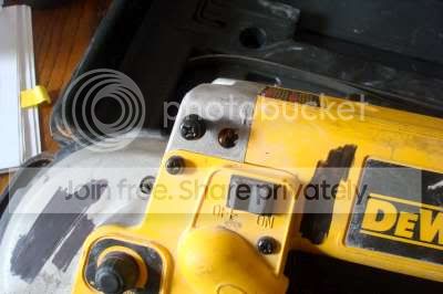

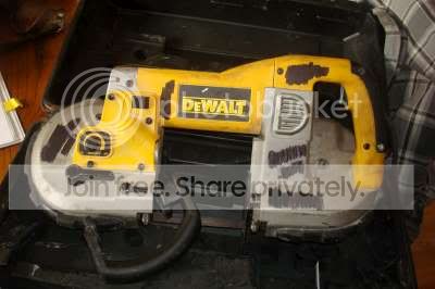

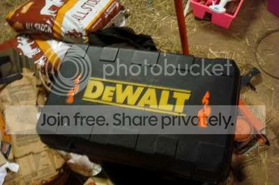

The bandsaw as it came.
Go ahead and take the plastic handle off, 4 screws, nice and easy.
I put the screws back in the holes so I wouldn't lose 'em.

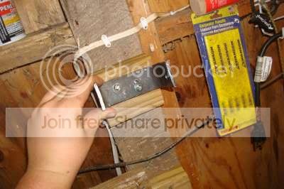

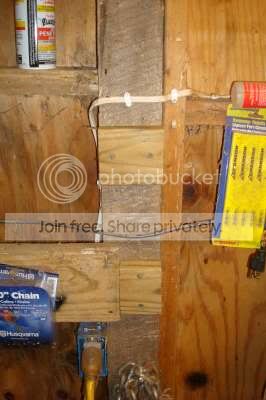

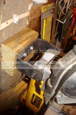

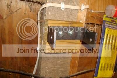

I found a nice clear spot by the wall, cleared some space on the stud, and got it ready. As you can see, I had a board sticking onto the stud, I couldn't move it so I took some scrap wood of the same thickness and put them where the saw sat up against it.

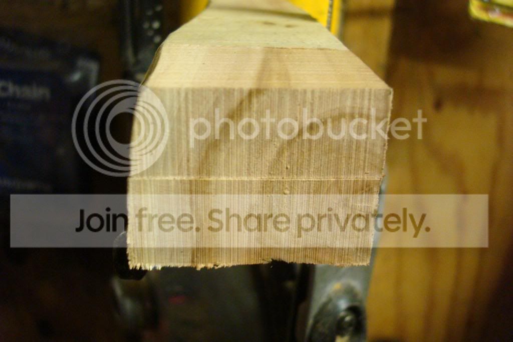

Bolting the bracket on the wall, all it is, is a pice of 1 ½ wide stock, bent to fit the holes for the handle on the bandsaw. It took me several tries to get it to fit right, but its not hard. Id give you the measurements, but the ones I took didnt work, so I wont mess you up. I used 1 lag bolts to keep it on the stud.

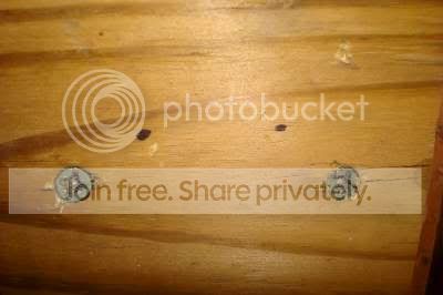

Holes for bolts marked

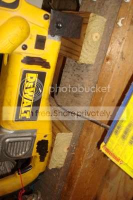

Bolted in

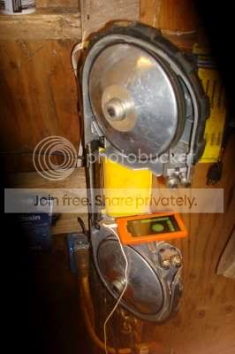

Saw mounted, making sure its level.

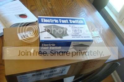

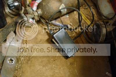

Electric foot switch I ordered from harbor freight. The box below is what they shipped it in, big enough?
Installing these things is difficult, plug it into the socket, and plug the saw into it, then ziptie the trigger down. Really hard.

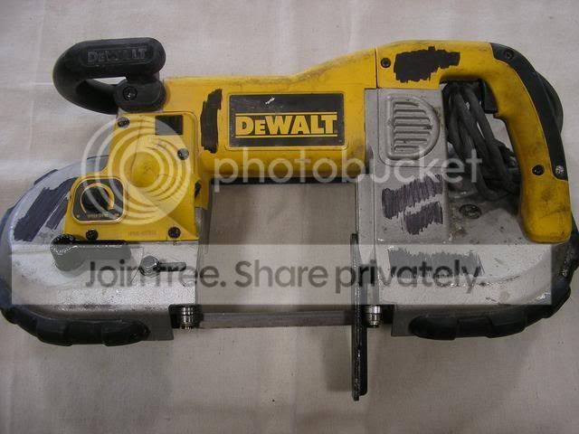

Here it is fully set up, I plan on making another larger table instead of the little black one, but this one will work for now.
While youre at it, coolify the case.
Some applewood scales I cut as a test, cuts well. Metal or wood.
