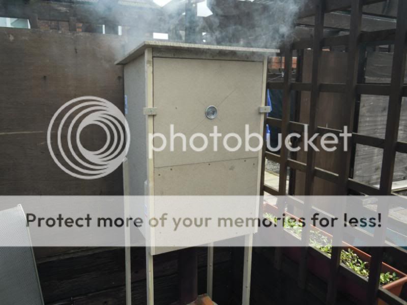

I thought i'd make a portable Hoy/Cold smoker Cooking System :thumbsup:

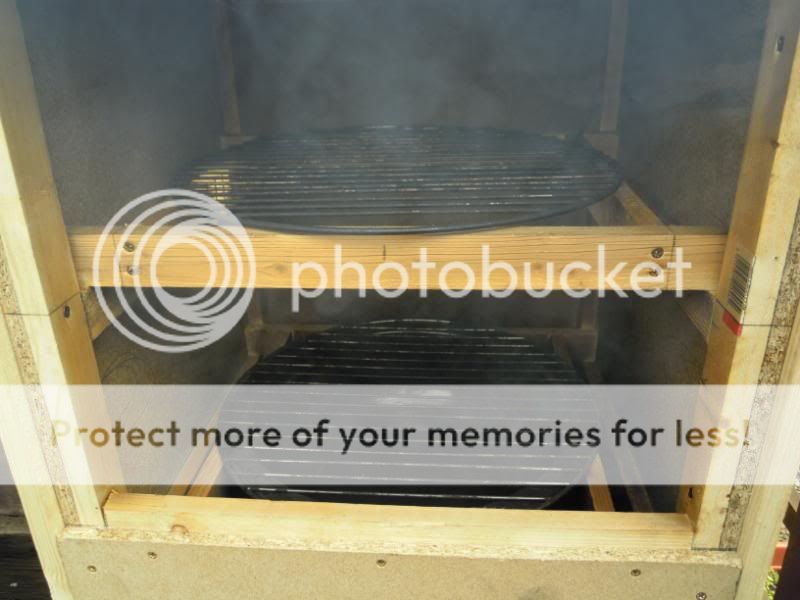

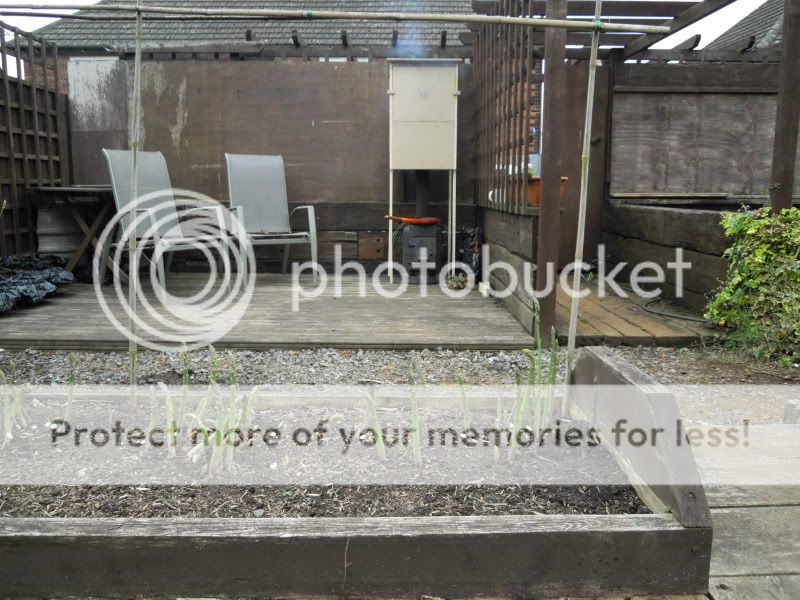

Its just basically an 18in x 3 ft Square box, on legs that unscrew for portability

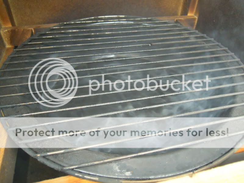

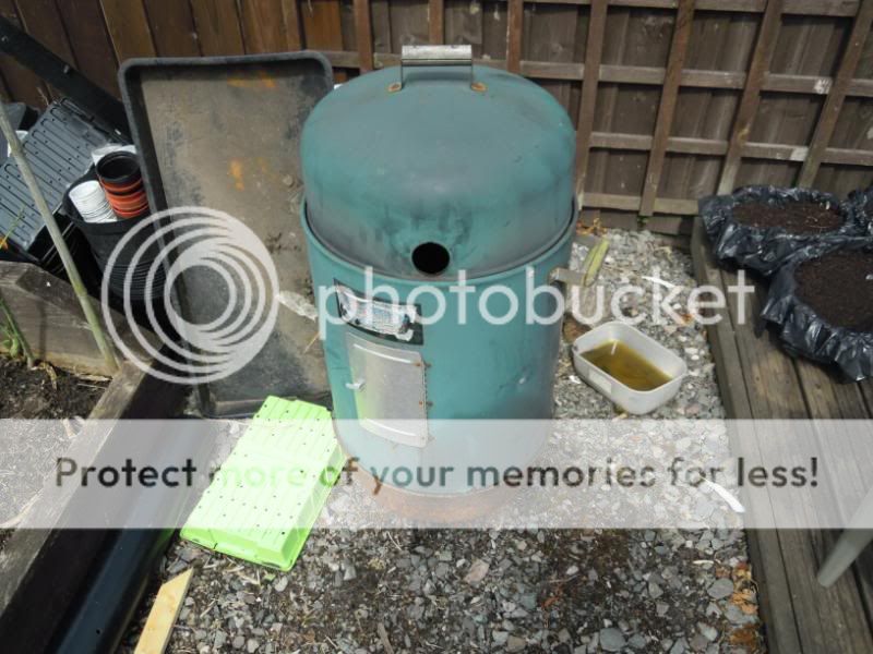

I had an old Brinkman smoker but couldn't get on with it, so cannibalised the racks and waterbowl from it :thumbsup:

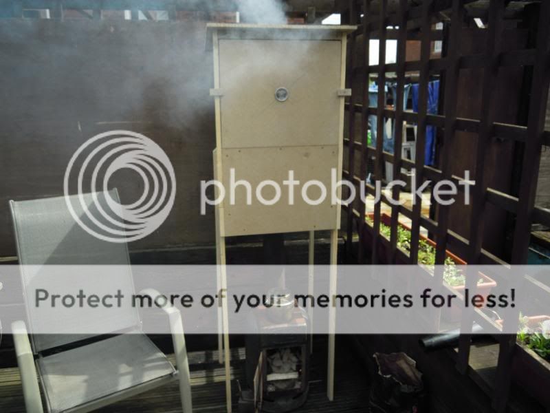

You can cook on the Gas bottle Burner, and set it up as in the pics for hot Smoking :thumbsup:
Am having some 4in elbows made by a mate,and going to fetch 3 more lengths of 4 in pipe from the Army stores,then will move the Smoker 12ft away from the Burner for cold Smoking
Am just waiting for the softwood to burn off,then will put the green oak on and will be trying it out with a full Chicken,will post more pics as i go along :thumbsup:

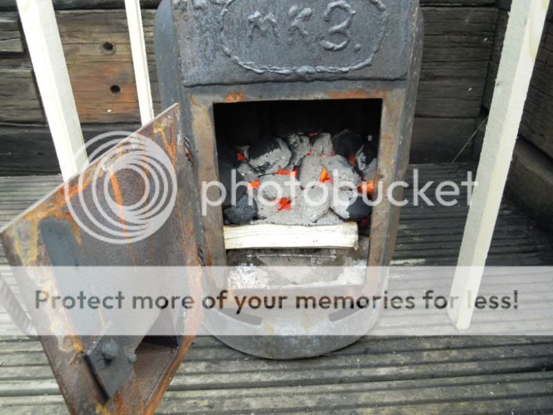

The gas Bottle burner,i never had much success with it,but placed to bricks inside and made a metal rack to raise it it works a treat now :thumbsup:
It now boils a cup of water in no time,so will be ideal for a Frying Pan or cooking anything on top
The cannibalised Brinkman

Smoking away

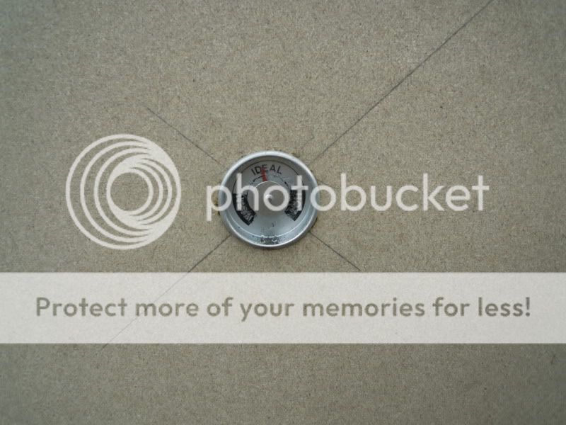

The right Temperature for Hot Smoking
I can easy take it down and put it up myself,so it will be coming with me for some of the Meets

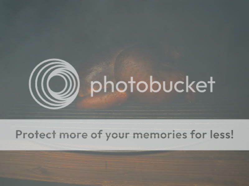

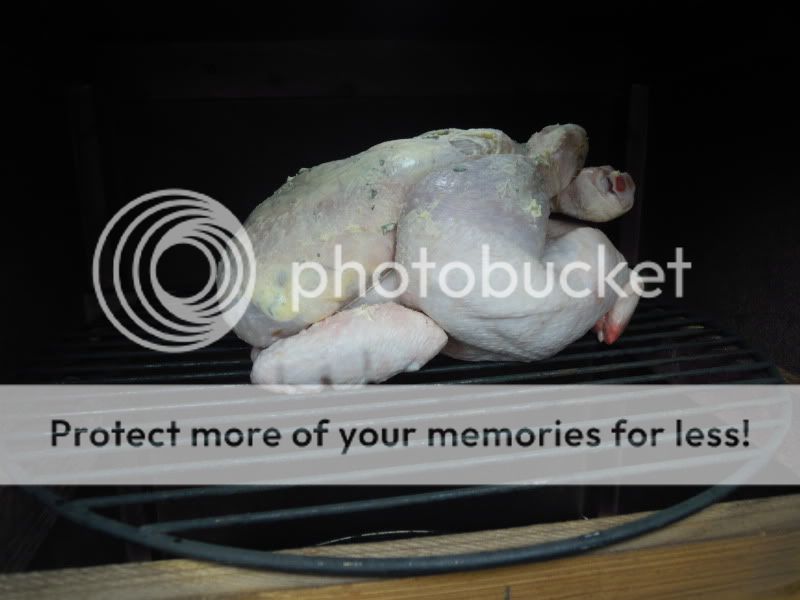

Well just put the Chicken in,smothered it with butter and fresh Sage, will check it in 3 hours :thumbsup:

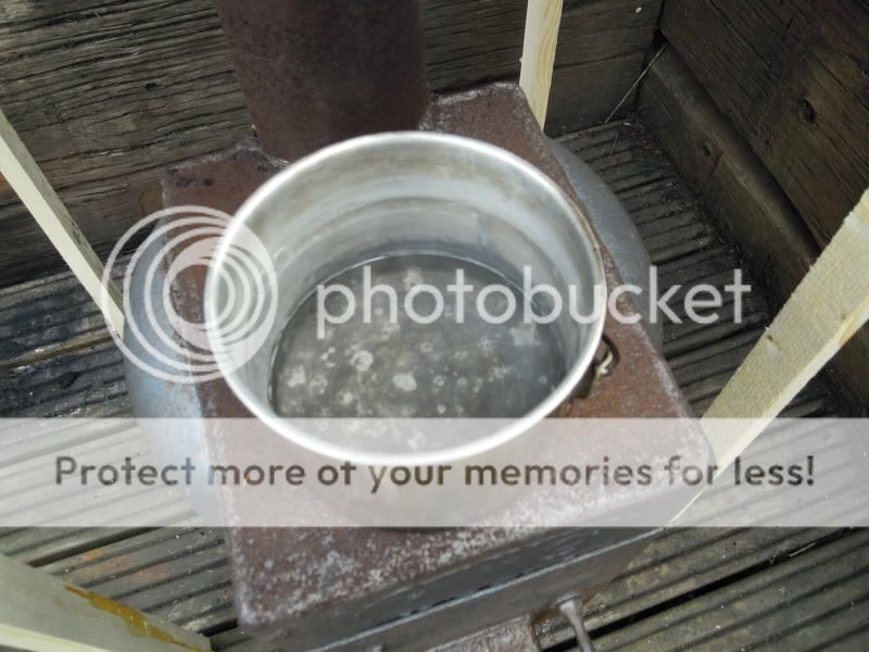

Filled the bowl with water i boiled on the top, so the Bird dosn't dry out :happy017:

Is the smoke box plywood or strand board, If so I might would have a concern with the glues used in their manfuracturing some are know to have formaldehydes. Other than that everything looks great.
Its Chipboard,so hope its not toxic :eek:will let you know when ive scraned the chicken :D:thumbup:

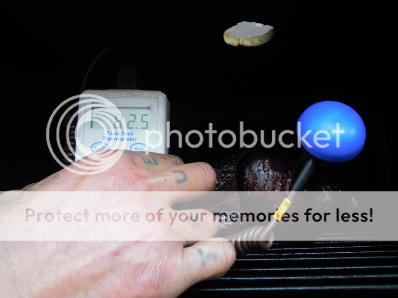

Been smoking away now for 3 1/2 hours, just tested it with the meat probe,not quite ready at 69c, needs to be between 75c and 85c, so will give it another hour :thumbup:
