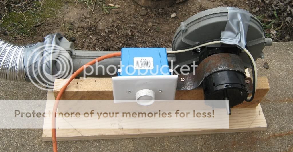

I love it when other people besides me come up with creative sources for equipment. As long as it can move enough air it should work, but its so small, that I doubt it. Since its so cheap, I say go ahead and try it if your forge is small. But if it isn't, and you happen to have an old gas furnace lying around, you can probably pull a blower out of there, like I did, for free, and it wouldn't be hard to hook up a hand crank to something like that.
My blower\/

A regular burner blower like shown above can often be had for free. Go to a heating and AC repair shop and talk to the folks there. They will probably give you an old blower. It can often be made variable speed by using a light dimmer.

I've actually been using this blower for several months and have been critisized for using a simple dimmer instead of a speed controller.
:thumbup:Very cool. I just use mine with a gate valve to adjust the air flow.
