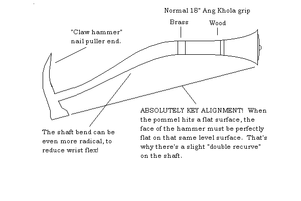

Years ago I worked a couple of summers as an assistant to a general contractor. I've known some other people in the biz too...one key thing they're always complaining about is their hammers.
The guys doing wood-frame housing get hit the worst. They use fairly large "pro grade" hammers with a straight wood shaft, and over a period of years it *really* screws them up, mainly in wrist and other tendon damage.
Soooo...what if you built hammers with a Khukuri grip and grip construction method? Steel shaft, stick tang, etc? Even a slight forward curve to the shaft would help "straighten the wrist during impacts". Give it about the same ergos as an 18" Ang Khola and you wouldn't be too far off.
Would they hold up? We're almost certainly talking about a "professional sales only" proposition, I imagine the cost would hover in the $75 - $100 range. But some guy slamming nails all day may joyfully pay that kind of money if it solves pain and injury problems, and if the things become fairly well-known major contractors could end up buying them in gross lots because it may be cheaper than the medical bills saved.
They'd have to be *tough* as hell of course. And as I recall, there are maximum standard weights that they're allowed to use per OSHA regulations, 36 ounces stands out in my head but I'm not quite certain. We'd have to find out. These big "framing hammers" generally have a hatchmarked face, they're not used for interior "finishing" work but that's not where the biggest problems are.
A trip to any hardware store should net you an example, if the clerks know what they're talking about.
I guess the Rosewood grips are less likely to crack than horn? If there's a specific wood less likely to crack, use it...'cuz these guys will abuse these babies on a steady daily basis that even Cliff Stamp can't even *begin* to approach.
Just a thought...in part, I'm thinking back to the "hungry kami" thread. These won't take quite the skill to make as a khukuri and the market is if anything far LARGER in theory. There's probably a few people on the forums who could test a prototype if it gets to that...?
I just thought of something: the hammer face has to slam down parallel with the target or you bend nails. That means, the only way to do a bent grip for better wrist position is a "double curved" shaft, one that comes up out of the grip, curves forward, then curves back again slightly. Done right the hammer face would line up dead on with the lower tip of the pommel. I could draw a picture if needed?

Pala, I understand completely. My only thought is that if you get big enough to saturate the Khukuri market this is worth thinking about.
Using a hammer requires little effort from the individual. There is no need to use much force nor should your grip transmit excess force to your wrist. In general it is much easier to hit something softer multiple times than hit it harder once. Let the hammer do the work, and if it can't - get a bigger hammer. You don't hit with a hammer like you chop with a khukuri.
I worked from 16-19 for my uncle who was (and still is) the owner of a construction company. Being the youngest one on virtually any job I always got to do the hardest labor. I did the carrying and pounding while someone else did the measuring and cutting. I never had a problem, neither did my uncles (4 of whom are carpenters), nor my grandfather who spent almost 80 years driving nails until the day he died.
-Cliff
Jim is thinking,but I`m with Cliff.I`ve pounded A few nails with a 28 oz. and 20 oz. Estwing with steel and wood handles respectivly. The wood is nicer to use.I wonder if H&H or Purdy would make me one with English scroll engraving?I`d have to go to England to be fitted,of course.I`d bet not.
