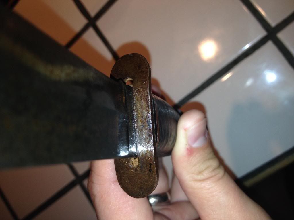

Hey guys. My cousin found this old Western Knife Co. blade in the attic of the house he has been renting for a while. Based on my research this appears to be a G46-6 "Shark". Supposedly these were fairly popular during that period for young men to carry in theater, possibly an issue item.(?)
[/URL][/IMG]
He is interested in using this as his deer hunting knife. He originally asked for me to restore it when he found out I have started working on/ learning to make knives. After learning of the potential history of it he decided against restoring it and would just like it bringing it back to presentable. I talked him into keeping that patina of the blued blade.
My questions to you. How should I go about removing rust from the blade without removing the bluing and patina?

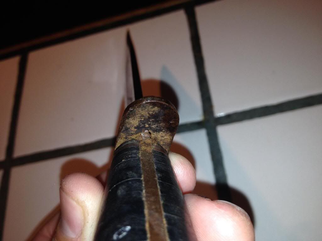

Also, it appears that someone either bent the guard down (it should be straight on both sides) or it is an aftermarket guard. Would one have to remove the leather spacers to install a new guard? Too me it appears that the original guard was bent down and they bends interfered with the spacers and causing a gap. This gap was filled with a thin gauge baling wire...
[/URL][/IMG]
Although it could be aftermarket as there are gaps on both sides of the blade...
I would like to see if I can either replace it or try to bend it back.
The gaps on each end of the guard are common. I have three with such gaps. Every Western sheath knife made for the Boy Scouts has a gap on the long side of the guard. Western seems to have just made the parts that way.
Bending guards was a GI pastime. Ditto for Marines. But usually they bent the top guard forward.
When I am trying to preserve a relic, "restoration" IMO being a theory like "honest politicians," I use a lot of mineral oil, rough paper or 0000 soft steel wool, and elbow grease. The black coming off over and over is the rust, until none/very little comes off. That prevents the knife from looking "new."
The biggest problem I have with Westerns is the rust between the tang and the ends of the leather handle sections. In some I have worked on, the rust has pushed the leather a good 1/8" away from the tang. I have found no really good answer. On one I reluctantly disassembled the handle at the owner's request, removed the rust with minimally invasive methods, and reassembled. I was not happy with the outcome. It looked "restored." There was still some gap at the tang. Oh well.

Say I was to want to try my hand at re-bending the guard back to original form, would I need to take the spacers off to remove it? I would be hesitant about removing the spacers, but also that I wouldn't be able to completely remove the bend.
Thank you for your helpful insights.
If you want to change what the soldier did, clamping the other end in the guard should, I think, provide leverage against that end of the guard as you change the other end. You can watch carefully and go slowly.
For my part, I try to conserve, not change. I got a helmet that had been creased by a Japanese round. I did not try to beat out the dent. But that's me.

The blade's actually in pretty good shape, so if it's going to be a user (and I see no reason it shouldn't be), frankly I would look into tearing it apart completely and building a new handle, rather than continue to cobble together "fixes" on top of "fixes". I'll bet you lunch, that tang is a rusty mess all the way down. Be careful removing that pommel...
I'd be very hesitant to soak the existing handle in vegetable oil. That may help somewhat for a time, maybe, but veg oil has a disturbing tendency to go rancid... not something you want on any knife, much less one that will be used for food or processing game. I would try mineral oil or a purpose-made leather conditioner instead, if I were so inclined. It will protect the existing leather to a degree, but it's never going to be "plump" and new again. Again, I agree with Thomas... once leather's been neglected that badly for that long, you're pretty much out of luck.
ETA: you may be able to peel that rusty baling wire out from between the guard and handle and replace it something more durable. Perhaps thin stainless braided wire or cord wetted with super-glue or epoxy...
