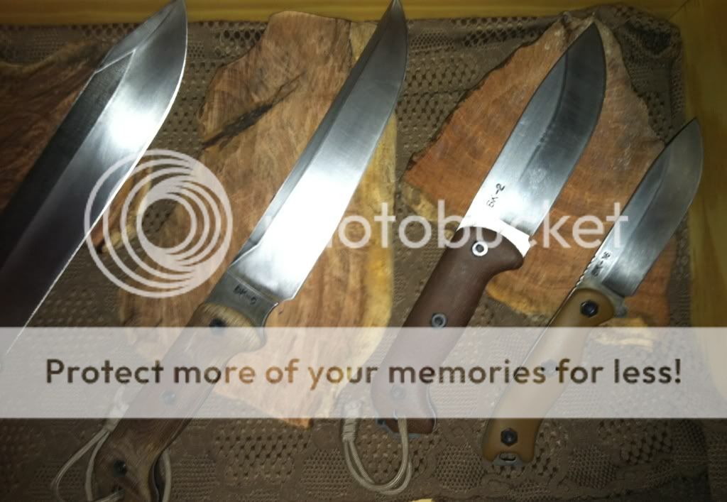

I just finished my BK2 "stripping project" today. (Didn't have time to do it all at once)
First , I removed the coating with a brass wire brush mounted on a power drill - took about 20 minutes because it was my first time ever doing something like this .
Then I sanded it with 400, 1000, 1500, and 2000 grit papers - about 15 to 20 mins for each grit (did the 2000 wet).
Then polished it with a cloth loaded with green compound - 10 mins .
Came out very shiny although not mirror . I had lots of fun doing it , seeing how the metal gets shinier with each step .
I deliberately left it unperfected because I like it more like this . And because I'm lazy .

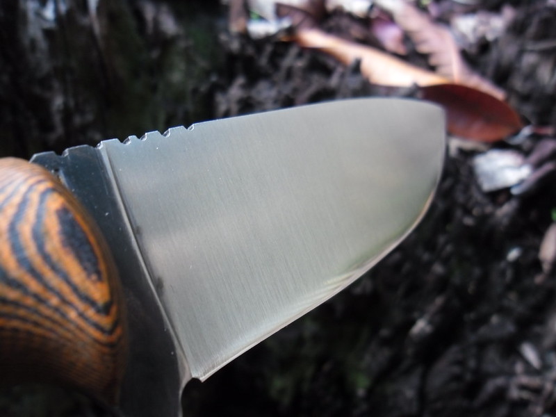

After the coating is removed the blade has a kind of stonewashed finish to it, kinda nice looking actually.
033 by CamH_16, on Flickr
Some 320 grit sandpaper and WD-40 puts a nice non-refelctive satin finnish on it and the closest I can get to actual sandblasting.
001 by CamH_16, on Flickr
