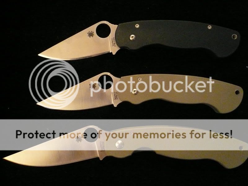

Spyderco made a Military out of CPM D2 but I think that those are sold out.
