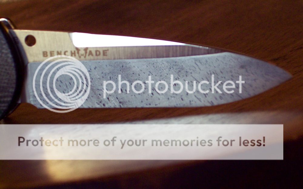

This is a BM 523 tanto I sanded into a droppoint:

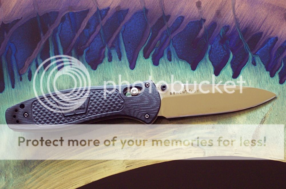

This, a BM Warn 583-1 tanto I sanded into a spearpoint:
Just take your time, one errant stroke w' paper can do a lot of damage.
