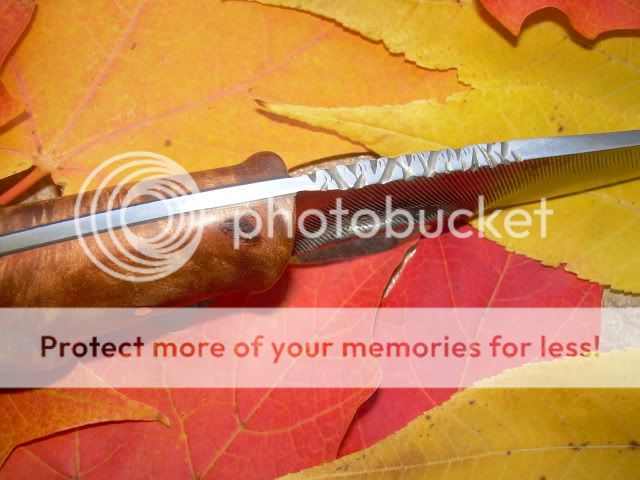

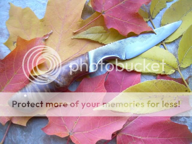

Here is my latest project forged from a old Nicholeson file. 8.5 inches OAL, 3.5 inch blade.
Claybacked for the quench and shows a nice temper line. Flaired finger guard. A random pattern file work on the spine. Burl handle, used Potassium Permangnate instead of stain and WATCO Danish oil finish.
