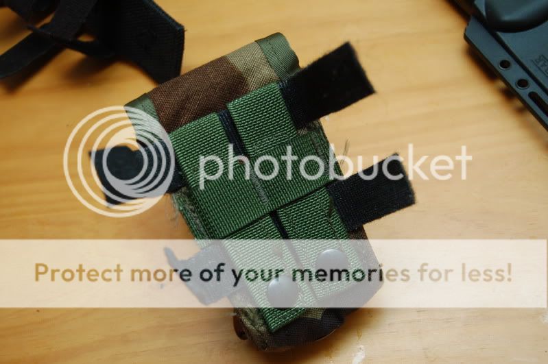

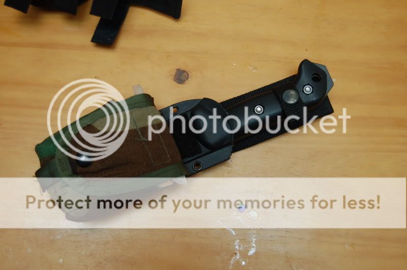

I've seen a lot of interest in a pouch for the BK2 sheath. so i thought i'd share what i use.
I take a velcro one wrap, and cut it it two 5" pieces. Then thread them through the pals attachment on a molle grenade pouch

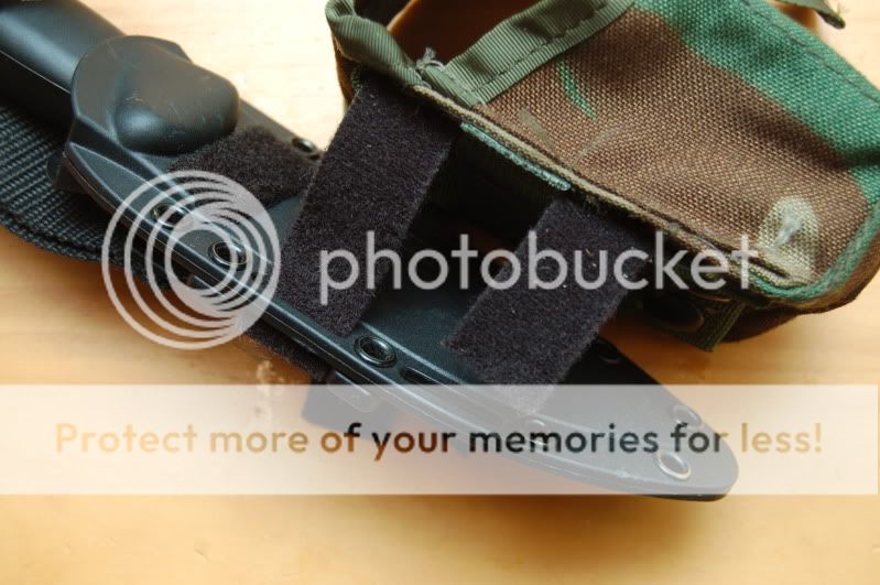

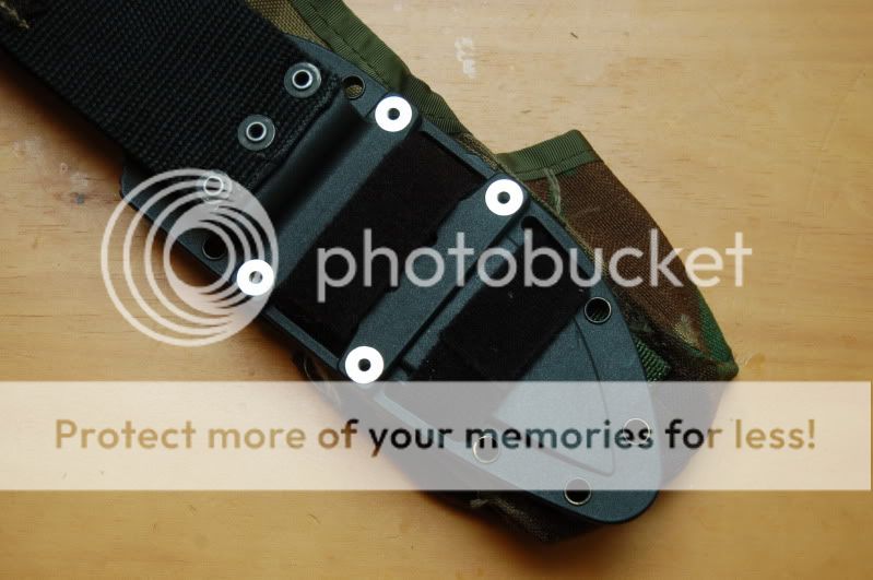

Insert the straps through the slots on the sheath.
Hook them together in the back. You don't even need to remove the belt loop.

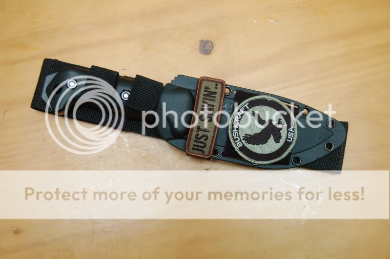

If you put the straps on without the pouch. it can be used as a velcro field for patches.
