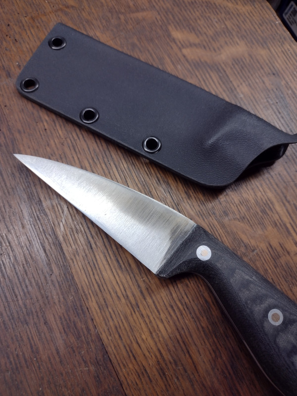

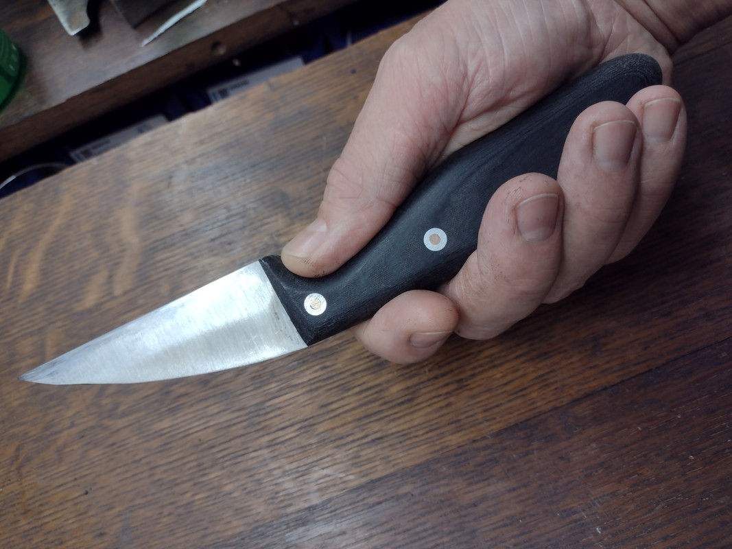

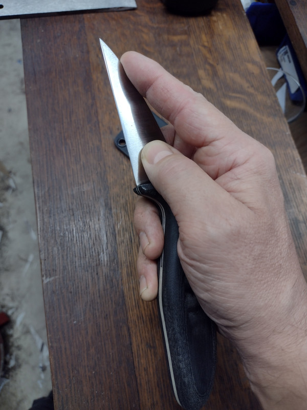

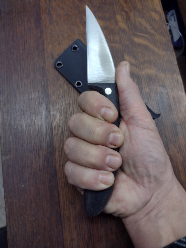

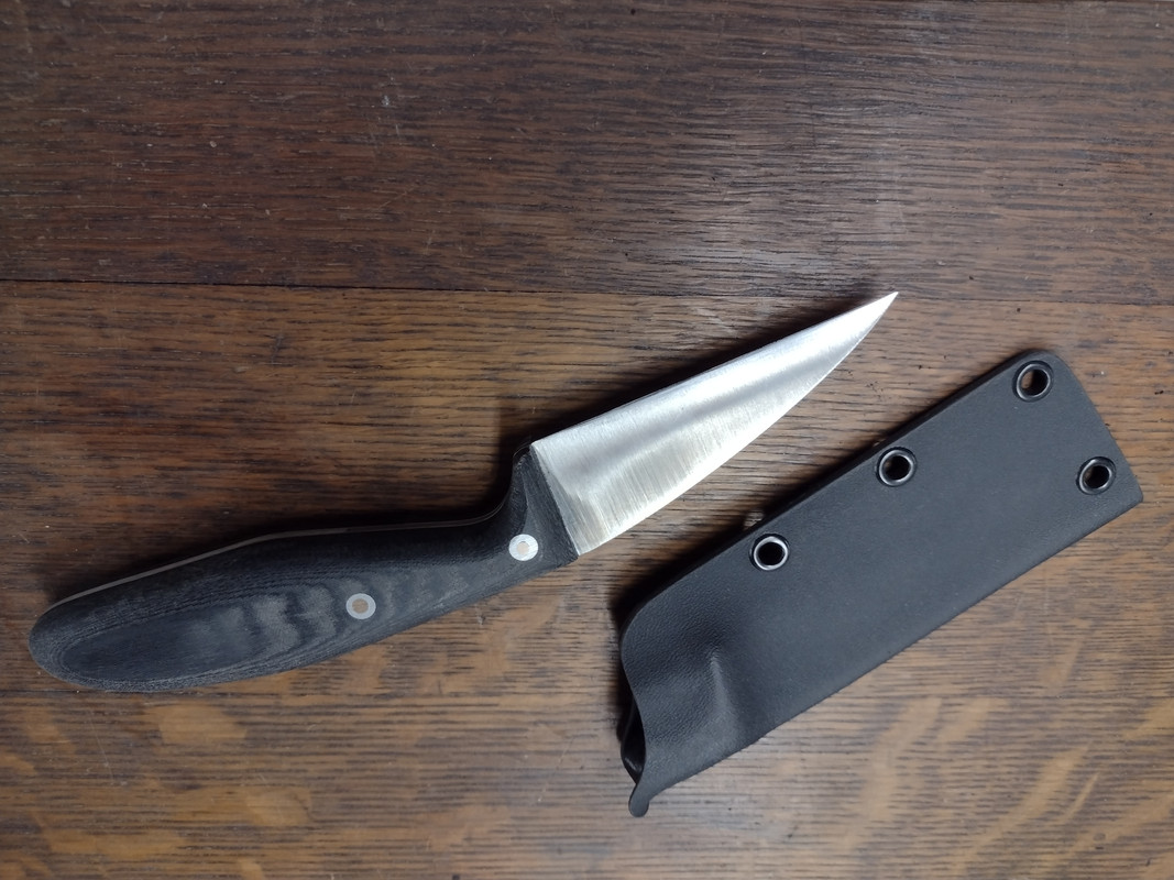

At work, a guy I know is a semi-pro trapper.
He has killed more things than Most on my side of the state.... When I told him that I was making knives, and I asked if he'd test one out for me. He agreed.
I was telling him about some high speed steel that I was using, and that it should last a long time. It Should hold it's edge for a very long time.
He nodded his head. He heard it all before. He's been doing this for a good 50 years. He knows the in and outs. He kills and cleans many hundred of raccoons, possum, skunks, minks, etc etc each season. The pictures are intense.
I was getting the feeling that he wasn't really believing me....ok.
I asked him about his knives. He said he was very particular. Modern knives just didn't hold an edge. He'd search out for older stuff.
He said that he sharpens a good 12 knives, all lined up on his table. Then go to work, cutting and cutting all the critters, not wanting to stop to sharpen.
Ok, so hunting and trapper season is over, I see him later on. He's ordering another knife. Never seen anything like it. He cleaned everything with my one knife. Unheard of.
I told him it would be good. M2 has lots of carbides, and it's over 64HRC. Very Hard. It just cuts and cuts, all day.
The next one he wanted was supposed to be more precise. For caping, and detail cutting, hitting skulls and bones, trimming. He wanted it more point focused.
I made it for him, he loves it.
Idk why, probably cause it's so comfortable in the hand.....he used it to clean and dress the bear his wife shot. I've never dressed a bear, but he says it's horrible on knives edge. He was saying the fat
But that doesn't make sense to me? Idk?
Anyhow....he spent over 5 hours using it on the bear, said it was still super sharp afterwards.
*And all that wasn't in a "super steel" wait until he tries some Cruwear..... haha.
