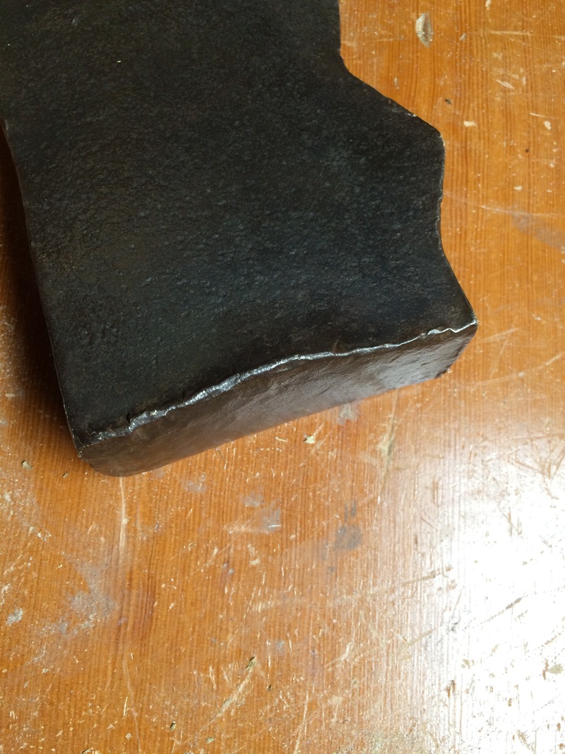

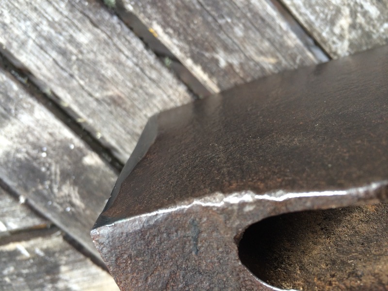

I have a few axe heads that are very mushroomed from beating on the back, 'poll' I guess is the correct term.
I don't want to file off that much material to straighted them out and pounding on them cold just doesn't seem to be getting the results I was hoping for.
My question is , would it be helpful or damage the heat treating on the bit if I try heating the poll up red hot to beat the mushroom back down ?

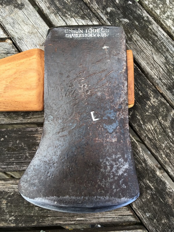

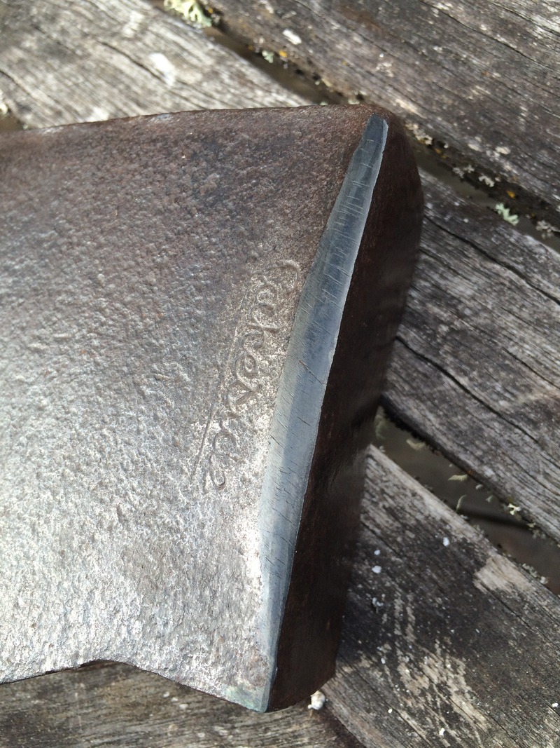

I was trying to save some makers stamps and that's why I'm probably being a little more ' delicate ' with them than normal.
1 appears to be a Maine style head with a stamp on both sides very close to the edge of the poll.
Yeah, nice old axes used as hammers need special help. Mushrooming with that sharp edge rolled over most of an otherwise readable stamp is my "favorite". Even better is if the stamp you want to keep also bulges up into your sharp mushrooming!
If I'm following what I think you are describing - I can only comment on moving some of it cold and using a file to keep as much of the mark as you can. That can be the least invasive but sometimes as time consuming as reprofiling a damaged bit.
Sometimes stopping short is fine too. I opted to stop on this head to keep the mark. This axe for example has a lot of cheek, is wide enough that the mushrooming is not going to catch on anything. The mushrooming is still evident but it is rounded/smooth to the touch:

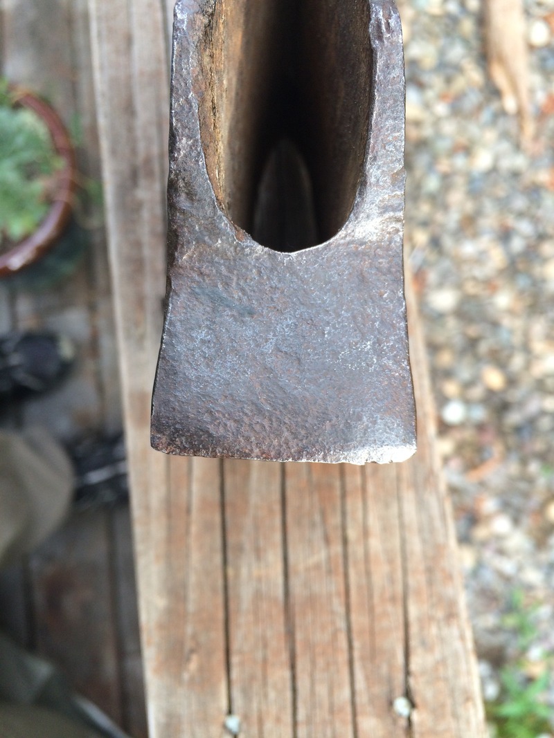

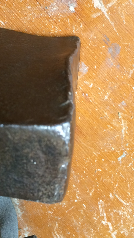

This 5lb Lakeside was mashed pretty bad, flanged out, and had a couple of jagged spots. Kind of depends on the situation as what your expectations will be.
Here are some things that I do or keep in mind for myself:
1. Run electrical tape around the head covering your stamp right under the mushrooming. Twice even. Of course a file or grinder can remove it but it gives you a reference and can be scraped a little before poke-through (poke-through is bad in most situations lol).
2. A stand-alone anvil, something used as an anvil, or a vise with an anvil plate is helpful. Use a small hammer to lift the edge of the mushrooming up and back from the mark a little bit. Also, removing the mushrooming off the opposite side first (the one now contacting the anvil surface while you knock down the stamped side) gives you some more control/stability to tap the lip back without messing up the rest of the area too much.
3./4. Flat file the mushrooming off while trying to get several angles of attack - trying to get at it from the stamp to mushrooming has left me the most intact stamp in many cases but that can be tricky depending on how long the axe head is.
If the "mushrooming" is really more "poll deformation" after flat filing the sharp lip off, you can use an appropriately sized hammer to maybe push a little more of it back into place before continuing your grinding - electric or manual. Doesn't hurt to bang, file, look, bang, file, look, etc.
* In some cases I've found hammering it down before pushing some of it back first can cause the lip of the mushrooming to curl over the stamp even more, making it harder in the end to clear it off/away from the stamp (because it is now flatter but material is more in the way when your file strokes become more shallow to match the plane of your poll/cheeks).
* As your filing angle flattens/becomes more parallel to the face of the of the poll on many heads you get closer and closer to swiping the cheeks/center of the axe by accident. We all know scratching the patina off of an old axe is a "First World Axe Issue". Here is a trick I use to keep myself from scratching up the rest of the head while filing the poll or reprofiling a bit - wrap the first 1"-1.5" in of your file in tape. Errant or unintentional contact with the face is at least lessened. I guess that also depends on how long your file is and the overall shape of your bit.
