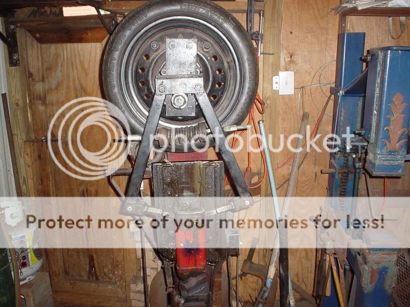

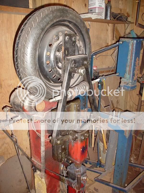

Hey guys,A friend and I built the first two tirehammers from a sketch by buddy Ray Clontz.These hammers are about 6 yrs. old and still going strong.My hammer dosen't look like much,but it has made me a good many $.Mine is powered by a 1/3 hp motor,A very simple design anybody with fab skills could build,it uses a little giant type linkage,which is where you get your bang.I would be glad to help anyone who wants to build one.Clay Spencer is doing workshops to build these hammers,over 200 built,he changed the slide design to use a tup in a tube.
