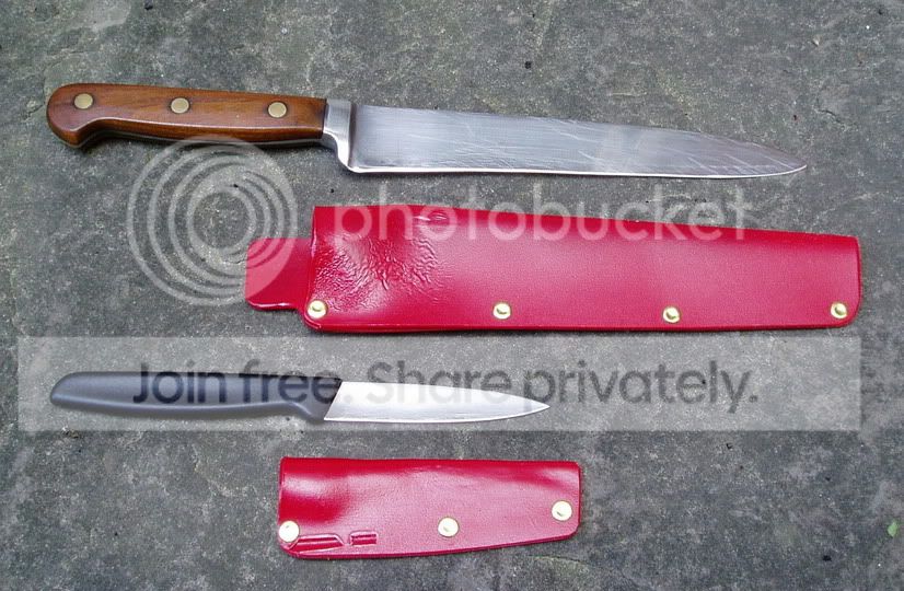

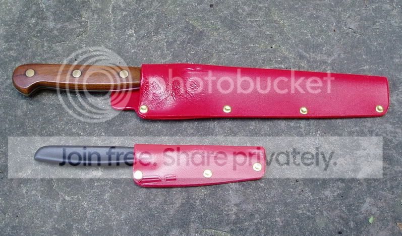

The next pictures show two knife sheaths I made to carry kitchen knives on canoe trips.
The plastic is from binder covers, meant to hold stacks of the old tractor-fed computer printouts. It's about 2mm thick, flexible but tough enough to be hard to cut with a knife (I use sheet metal shears).
I pinch the sheath just above the guard while it is still hot. Once it has cooled, the knives snap into place very securely. The marks on the large sheath come from pressing the hot plastic with a leather glove that I was using to protect my hand. The rivets in this case are two-piece brass rivets that you just hammer together. Both these sheaths have big enough gaps at bottom that they drain easily, but they are harder to clean than your design.
I'm sure Kydex is tougher, and probably can be formed more precisely, but for utilitarian sheaths like these the cheap stuff does fine. It would be interesting to build a proper press and see if one could do as good a job as with Kydex.
