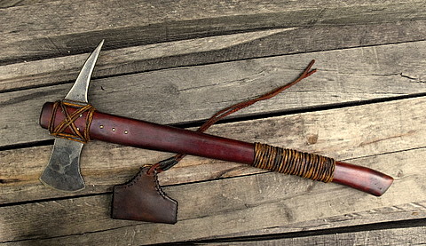

I have a piece of steel a 1/4 of an inch thick lying around, and I am wondering about a design for a practical wood hatchet that I can make out of this. The main problems appear to be the that the steel is a bit to thin to split the wood apart like a traditional axe, and attaching the blade the the haft seems troublesome. I have thought of three ways of attaching the head, a full tang design with scales on the sides, a slot starting at the top of the haft with a 4 inch tang inside, and a slot starting about an inch away for the top just big enough for a simple axe head to be inserted into it. I could post this in the knife making section but wanted the opions of the axe experts (as I know very little about axes). Feel free to post picture of stock removal axes you like, comment on my design ideas, and comment on stock removal axes in general.

Though the axe you mentioned looks like a bit of a gimmick. I was already thinking of doing something like that except with a little bit more "tang" and using pins to attach it instead of lashing it onto the handle. I was wondering if it would be strong enough, if the wood on either side of the head would be worn away, and in 1/4 inch could split anything as well as an axe.
North river custom knives makes some axes a bit like this.
it wont be a good splitter that's for sure. Its too thin and wont have meat in the right places.
Its the taper of the axe head that makes it split well.
If your axe head is 6mm at its thickest point you wont have enough material thickness to grind in a taper that will split effectively. Also removing steel from the 6mm starting thickness to make your taper is just going to reduce the head weight further. It will end up being physically very large and light for its size, which in itself is also not a good combination. (you want more weight/force concentrated on a smaller cutting edge/blade)

There are hundreds of versions of tac hawks and Bare Grills-type survival hatchets out there made from flat bar using pinned scales or paracord/leather wrap. See if you can adapt one of these designs for your own purposes. If a practical working tool for chopping and splitting larger-than-branch-sized material is what you want it may be time to visit a blacksmith with that piece of steel and have him/her forge fold it over to make a proper eye to accommodate a handle and be able to give it a decent blade slope.

True, Square_peg. Still, I doubt insisting on making a light hatchet out of such thin stock w/o forging/bending, you can find a more durable design. If those scales come off, it means they've been poorly attached - they hold up just fine on big choppers and I doubt such a design would sustain more stress than a 3-4 lbs kukri. I suppose it would be used for kindling, mostly. OTOH, with bad technique anyone can ruin the best ax handle in the world.
One problem I have with this design is that it is usually a "tacticool" approach :), that I absolutely abhor. However, drop the abrupt lines, and put some nice wooden scales on it, and I'm becoming less grumpy about the idea :). I have one in O2 steel with wenge wood, received as a gift, and it's a cool little thing. That was the 1st one I didn't hate :).
