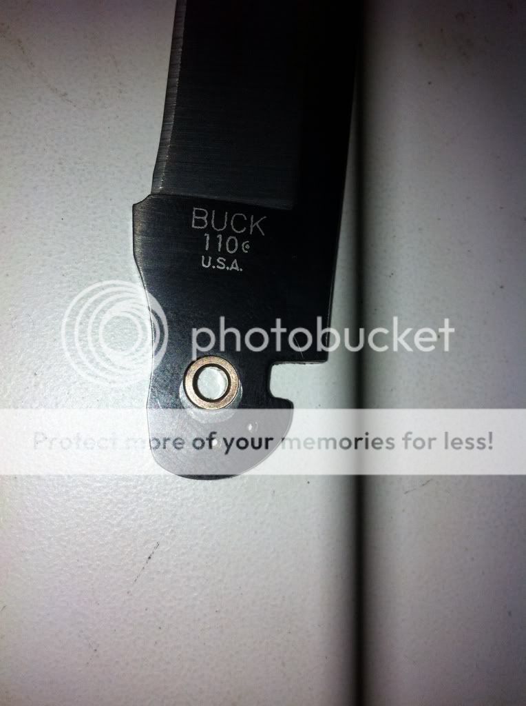

I just took apart a (late?) 2011 Cabelas AG S30V and look what I saw! Looks like perfect for a (two spots??) 1/16 coil spring hmm... What else could it be? Particle traps?
very cool find Jerad! No way that they would be detent catches for a Liner Lock...wrong tang shape...scatching head.....scratching head......secret military project???
I could be some type of jig the blade is placed on while they coat them,might have something to do with it.
Sorry to put an end to any excitement, but those holes are for steel Identification only. No hole= 420HC, 1 hole = Sandvik, 2 holes = S30V.
This is a newer method to track blades so steels do not get mixed up.
Wonder why they'd punch a fairly large hole instead of just making a mark?
We put the hole(s) in when the parts are being cut with the laser. Makes one less operation down the road, and much easier to track.

The point of the small holes is to identify the steel going through the entire manufacturing process. The steel has to be thinned down, hollow ground, heat treated, and be given some sort of finish. If it were laser marked on the surface after being cut out to identify it. Then after one of the first processes there would be no way to ever identify it again. A hole is permanent and will visually aid the blades through, so the consumer does not get a 420HC blade marked S30V.
You can look at a Vantage Avid and Vantage pro Tang, (when the blade is closed) and you will see one has 1 notch and the other has 2
The 110 could not be notched on the tang because the rocker rides on the radius of the tang.
Hope this helps.
