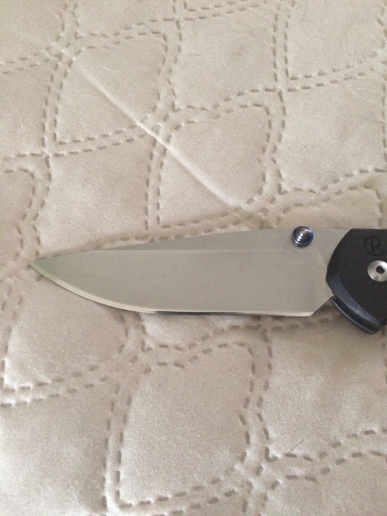

So I was playing around with my KME and new roo strops.
I noticed that I could no get the edge shiny through out the entire lenght of the spyderco PM2. So I placed the angle cube centered right above the edge of the blade (on the holder). And moved the holder back and forth slowly. The angle continues to change. Tip 20° and heel 18.50° . Taking a closers look at the scratch pattern it's very noticeable.
I'm wondering if I'm doing something wrong or that's just the way it is? Does the Wicked Edge have this same quirk?
It could be the factory grind too. A high powered 2x72 and a second longer on one spot vs the other can make this .is it a consistent problem or just the one knife?
I can put any knife in the clamp, set the arm and angle cube up. Set it example 20. Now if I just slowly move the arm up and down the travel path the angle will change. Higher at the tip, the angle I set it at in the middle and like 2 degrees less at the back of the blade.
I set the blade as centered and straight as I could... I'd like to have a 22.50 angle through the the blade if possible.
It also matters where you clamp the blade, you have to play with the position in order to get a consistent angle over the entire length of the blade. The center of the blade is rarely the "sweet spot" for getting the bevil even:)
It is possible that you press to hard on the sharpener during sharpening. There is a little flex in the guide rod - and that flex will give you a convex edge in about 1-1,5 degrees.
Try to sharpen the same knife again, now with very light pressure on the sharpener. It takes a little more time to do - but the scratchmarks will be veey small and innthe end you will get a veey shiny edge without scratchmarks.
Scratchmarks comes mostly from the first course sharpener you use, and to hard pressure. Next finer sharpener can not grind those scratchmarks away - if you dont let it take a lot of time to grind them away. The third sharpener with even finer grit makes the scratchmarks dissapear (for a while) - but when you start ro polish the edge - the scratchmarks are visble again...

Well I tried a different knife (beater knife) and th bevel looks nice like glass. So the look is uniform... But still following the path of travel with the angle cube shows the angle constantly changing... I'll have a read throw guy that thread tonight after work. I'd love some clarity. I'm enjoying learning and experimenting with different stones...
Are you sure it is not just an erratic reading on the angle cube? When you move the pivot arm sideways, do you rotate the angle cube on top of the stone holder so it stays at a a 90 degree angle to to edge?
Yes and I let it settle. I'll play with it some more after work, I'll see if I can get some pictures.
