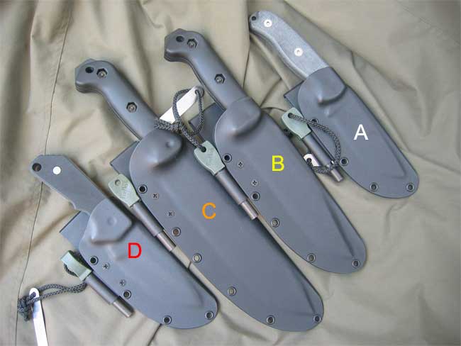

Hey Guys..
This is how I put a Firesteel on a sheath...
ttyle
Eric
O/ST
I am sure eric will chime in, but I believe that blade is the ontario TAK in D2 judging by the color of the handle...great knife by the way. Bark river includes a firesteel loop on the leather sheath they ship with the Aurora as well.
