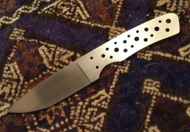

Little progress update, filed in my plunges, which turned out fairly even and by no means perfect. Also have my bevels about half done, planning on a FFG.
I've got my k26 bricks and Atlas burner on order, and I'm starting to research sharpening solutions. Do you guys have any suggestions in that department? I understand that the affordable guided sharpening systems don't maintain a constant geometry from plunge to tip on knives like this, but I'm not sure if that's a big enough concern on my first knife to negate the ease of use. I'd like to learn freehand sharpening for sure, but if I get all the way to the point at which I'm adding a secondary bevel, I don't want to screw it up!
(Waiting on my step bits to come in to chamfer and take out some weight from the tang)

Nice work googlebutt. I'm busy with a very similar profile, also on a filing jig. I would second the suggestion for getting decent drill bits, the cobalt ones work for me. I may have gone a little drill crazy on mine, it's probably better to drill fewer holes but larger ones for the epoxy to penetrate:
As for the final sharpening I think a guided system would be fine. I use the Edge Pro with the standard stones and whilst it's not the fastest way it produces a good result and the process is anxiety free.
Good tip, thanks! Is there a method for reducing the guesswork in regards to how much material should be removed from the tang, in order to balance the blade?

I don't think the holes remove much weight unless you really skeletonise the tang with a bunch of big holes down the center line. The main purpose of the holes is so that the epoxy is connecting scale to scale and not just scale to tang.
It's also a good idea to drill a bunch of shallow holes in the scales down the center so that the epoxy has more to grip onto and doesn't all get squeezed out during clamp up. Well that's how I do it.

I've finished filing the bevels and now I'm onto draw filing everything flat. I left some extra meat on the edge, but I'm curious how this I should make it considering I'm hand filing?
