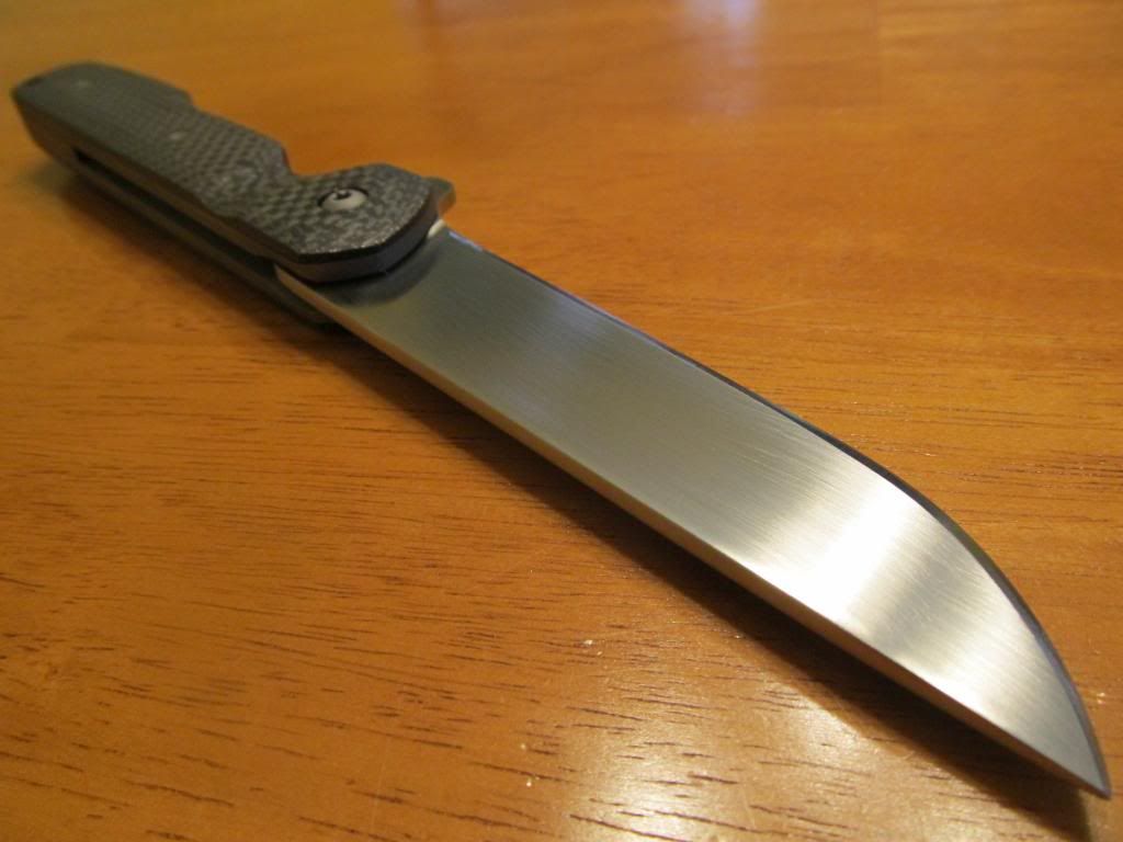

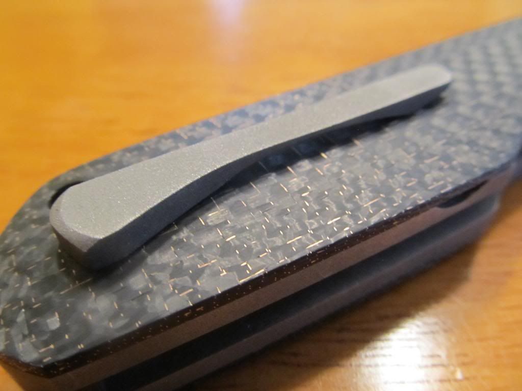

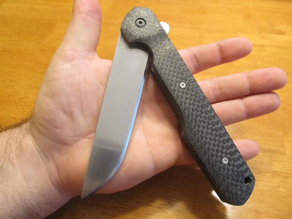

thanks to all those who helped me with all my questions along the way to making this knife. i have been making knives for a very short period of time but have learned a great deal from many great individuals. ive found my true passion!
this piece is the ,thus far, culmination of my skills. hard earned through trial and error and hard lessons.
Oal 10 3/4 inches
4 3/4 inch blade .150 10v
.125 ti liners
lcsf overlay
hidden stop pin and hardware
closed length 6 1/4 inches
and a video of the action.
http://www.youtube.com/user/buktush#p/a/u/0/gkvQF3ksr4s
thanks again and as always...more to come!
Beautiful tool. Nice choice of materials and clean lines.

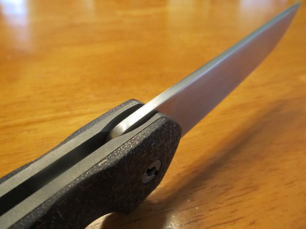

Peter, gorgeous knife. I love the handles, and I really love the clip. I still think a swedge would have helped the look of the blade, but it has a simple elegance to it as is. I like the hidden stop pin, but the blade cutout still concerns me structurally. I think you could obtain the same effect by cutting that arcing slot into the two ti liners, and press fitting the stop pin into the blade. I hope I'm not coming off as annoyingly critical, I think you do great work. I look forward to future projects.
