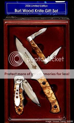

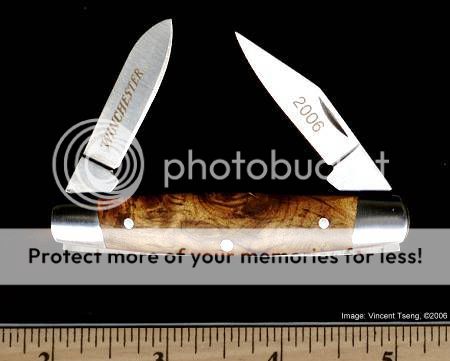

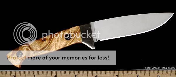

actually pretty good looking (to my eyes), and cheap -
Spotted at a local WalMart priced at $20 for the whole set
.... less than $7 per knife - that's really cheap -
so what's the catch?
That's 420 stainless steel - which is regarded by some as "junk" steel.
However CRKT are using it in a lot of their knives - I have been EDC'ing a CRKT Ichi (review linked) which only has 420 - and admittedly I consider myself a "lite" user - the blade and edge has held up well - I have only had to retouch the edge once, and only by stropping on cardboard.
The look and feel of these knives is pretty good, and they do look pretty, and probably very servicable -
Fixed Blade (comes with a nylon sheath)
The handle on the fixed balde seems a bit on the small side - even though it fits me reasonably well - I can see it being too small for big hands.

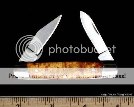

Stockman -
two bladed and the clip blade seems short for the handle size.

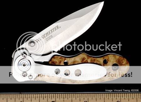

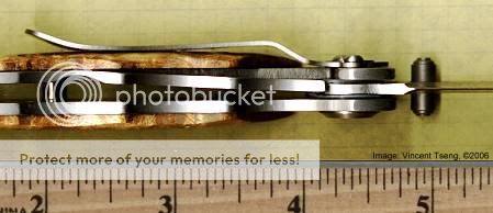

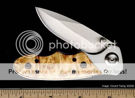

One-hand opener -
This one feels heavy for its size.
But it is essentially a Frame-Lock (not bad for less than $7)
Hopefully the pictures show that these knives are pretty well made.
Obviously there will be variations in the burl wood - I had 6 packs to choose from.
Although these probably will be bought for the looks (and I think they are good looking) they do look and feel servicable - with the understanding they are 420 steel.

to my knowledge, theres quite a difference between 420j2 and 420hc
so i wouldnt compare the CRKT steel to this set.
btw... if your interested in the folder... get the aus8 version from knifekits.com and just slap those burl scales on.

Sorry to contradict you -
BUT the CRKT Ichi is 420J2 - please look at the review that I linked above.
this is from the CRKT catalog page -
Also right on the CRKT.com web page of the Koji Hara Ichi
QUOTE:
Blade: Length: 2.50” (6.4 cm)
Thickness: 0.096” (0.245 cm)
Steel: 420J2, 54-56 HRC
Closed:Handle length: 3.25” (8.3 cm)
Open:Overall length: 5.625” (14.3 cm)
Weight: 1.9 oz. (54 g)
UNQUOTE
If you go through the CRKT current catalog you can see for yourself quite a few knives use 420J2.

As stated above, there is more than one 420 stainless. Heat treat is critical to getting good performance out of any steel. In my opinion, it is even more critical in 420 than, say, S30V. The only real experience I have that may relate directly to these is a Winchester branded, made in China, three blade stockman I got in a lot of knives I bought some time ago. It sharpens about as easily as Velveeta cheese, and holds an edge nearly as well.
You get what you pay for. I would be pleasantly surprised if I found 3/$20 knives usable. YMMV
While not disagreeing that heat treatment can make a huge difference in knives - and no, I do not know how well, or badly heat treated these knives are.
(Important Note: this logic means one could have any S30V or ZDP steel that's poorly heat treated - so basically "junk" too - probably less than any 420J2 that's well heat treated)
However I will give at least two notable examples of knives at about or less than $7, that are more than merely servicable.....
Opinel #8 and smaller
Victorinox 3.25" paring knife (as low as $3)
