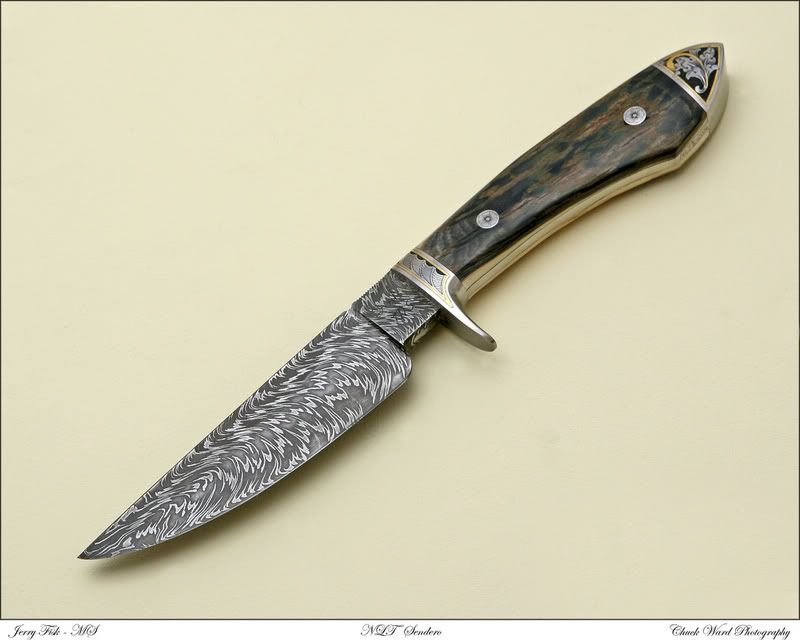

If I remember correctly it took Jerry about 4 full days of experimenting, welding and hammering to get the damascus pattern just the way he wanted it on the knife below.
This thread gives an idea as to why damascus adds cost to a knife.
http://www.fisk-knives.com/Progressive_W_pattern_Sendero.html

Some examples:
Keep in mind that not all damascus is the same - as Kevin's photos beautifully illustrate. I happen to love random pattern, but it doesn't reflect the same investment of time, labour and creativity that some of the more complex patterns do. There are a lot more steps and a lot more opportunities to screw up.
Is there a discrepancy in pricing? You bet. Some makers will charge more of a premium than others. But that is just one factor to consider in your overall assessment of the value of the piece. The search for uniformity in pricing in custom knives will ultimately be a fruitless one.
Danbo does raise a valid and often-overlooked point - finishing a carbon steel blade exceptionally well is reflective of significant labor and talent as well. Take a look at a carbon steel bowie by the likes of Hancock, Dean, Newton, Wheeler, Andrews (not an exhaustive list) and ask yourself - why doesn't everyone do it this well? (Answer - not everyone can).
