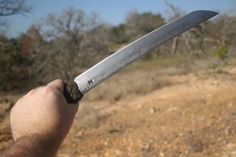

Just finished up this long tanto.

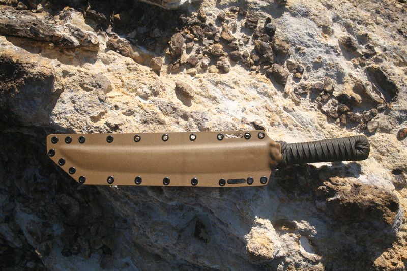

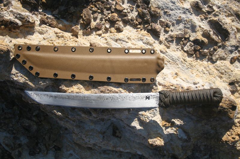

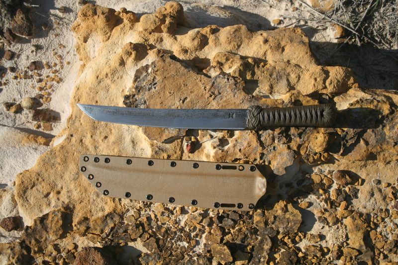

The blade is 11 1/2" long, forged from 80CrV2 steel, and the handle is marine epoxy-impregnated tan-over-black paracord on top of a neoprene foundation. And a tan Kydex sheath with a set of webbing slots.
There are a couple of things I tried on this one that is new to me. I have forged the spine thinner on some previous tantos, leaving a rough ridgeline. This time I filed the bevels as well. Also, the bevel at the kissaki is a thick penetrator edge rather than a slicey edge.
