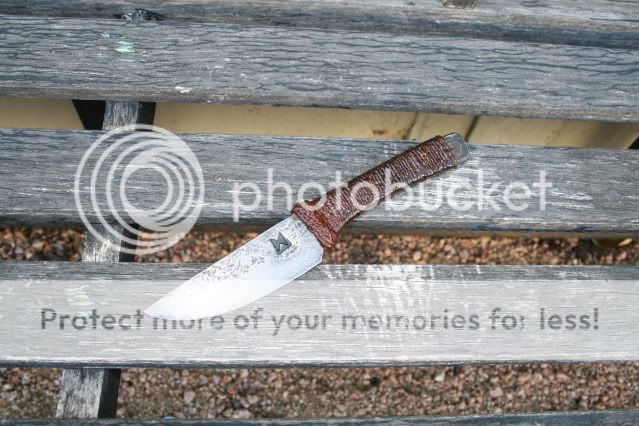

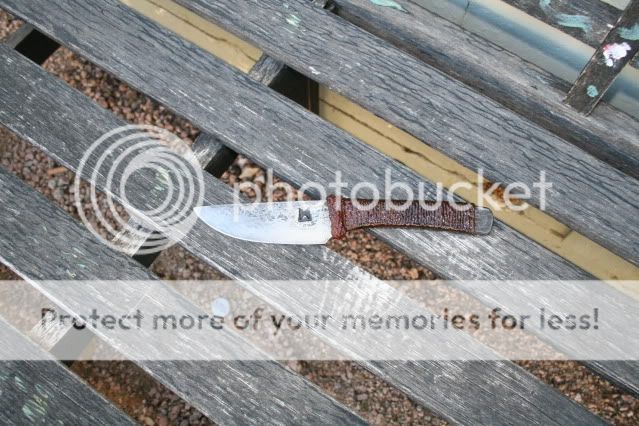

I had a fellow stop by my table at the last gun show who liked a couple of knives I had for sale, but wanted something between the two. I wrote down the details of what he wanted and his contact information and told him I'd get started on it Monday. A couple of weeks later, he picked it up, quite pleased with the outcome.
Approximately 4" blade forged from 3/4" round 5160 bar, triple normalized, filed primary bevel, triple quenched, triple tempered, hemp cord main wrap, cotton cord two strand Turk's head knot, amber shellac sealer, shaving sharp.
