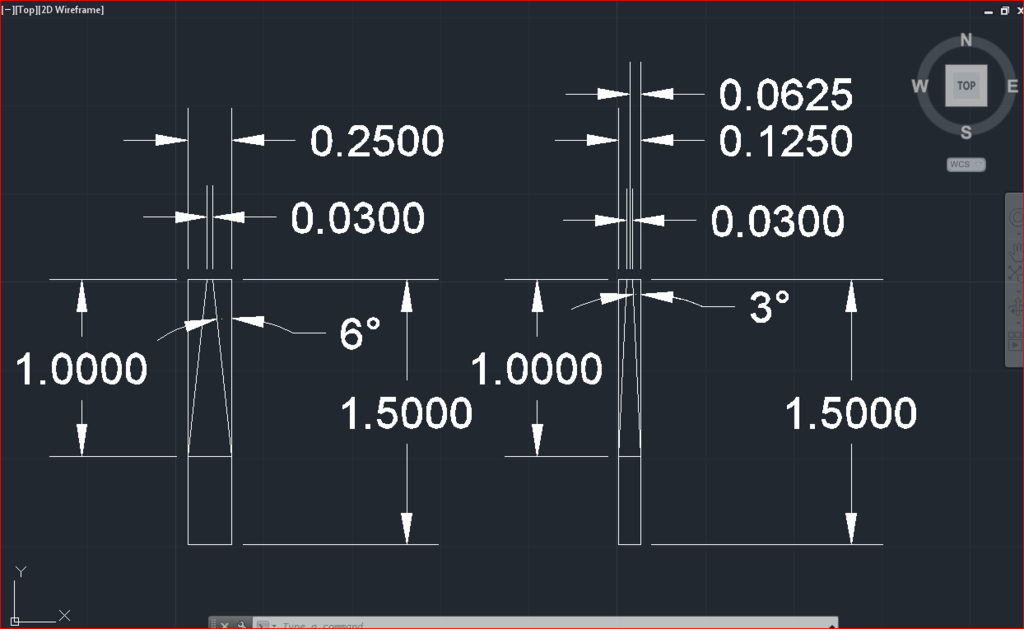

Ok so im starting my second knife. The first that i will temper. Its .15 inches thick and the maximum blade length from spine to cutting edge is 1 inch. Im going to go for a flat grind and would like suggestions on a bevel angle. I want a sturdy slicer so i imagine it will need to be a low angle. I have a jig to hold an angle but if i set it for 10 degrees wouldnt that give me a 20 degree overall bevel angle?
Throw the jig away and grind buddy! Just grind from the center line of the edge almost the entire way to the spine. Leave some room on the edge if you're grinding before heat treat. .30 thou or so. Think the thickness of a dime. Every blade is different depending on its expected usage, material thickness and size. Look at the pics posted all over this forum. You'll notice how similar the grinds are. Remember, thin is in!!
see... now i would argue to jig. to each their own, but i know if i'm going for accuracy i still use a jig a lot of the time, it's just one less thing to have to be as good at, lol
So for a .15 thick knofe and a bevel that would be .8-.9 id be looking at at a 5-8 degree bevel per side by that chart right?
Not quite, for a 1" bevel height with 1/8" stock you grind each side at a 3.6 degree angle. Your stock is a little bigger so you would have a slightly larger angle. You have to interpolate between the two nearest sizes. These angles are just to get you started. Set the angle then grind to either .015 of your marked center line or to the height of the grind you want, whichever comes first. Then you will need to adjust your angle so as to get the final grind height and edge thickness that you want by eye.
Ok when you say .015 of center you are reffering to a line that would be drawn exactly in the middle of the .15 stock on the opposite end of the spine? That is to say what will become the cutting edge?
Yes, I draw a line down the center of what will become the edge. I say to grind to within 15 thousands of this line as you want to keep the edge at 30 thousands so your blade won't warp during heat treat. by keeping .015 on each side of the line you come up with a .030 edge.
Ok i understand perfectly now. And when you say adjust for the final angle i assume you are meabing the second bevel angle that will become the acual edge. 20-25 degreesor whatever i end up deciding on?
No, what I'm saying is that it's just about impossible to set your jig to the exact angle you need. The chart will get you close, but you will need to adjust slightly to get your bevels exactly as you want them. You won't know what this adjustment is going to be until you have ground 90% of your bevel. If your initial angle is to steep your grind will hit the center line first. If it was too shallow, you will get to the bevel height first. Once you hit either of these desired dimensions stop and adjust your angle, so that your grind meets both the edge and bevel height at the same time.

Here is a comparison drawing between an 1/8" thick blade and a 1/4" thick blade with a 1" bevel leaving .030 for the heat treat.
