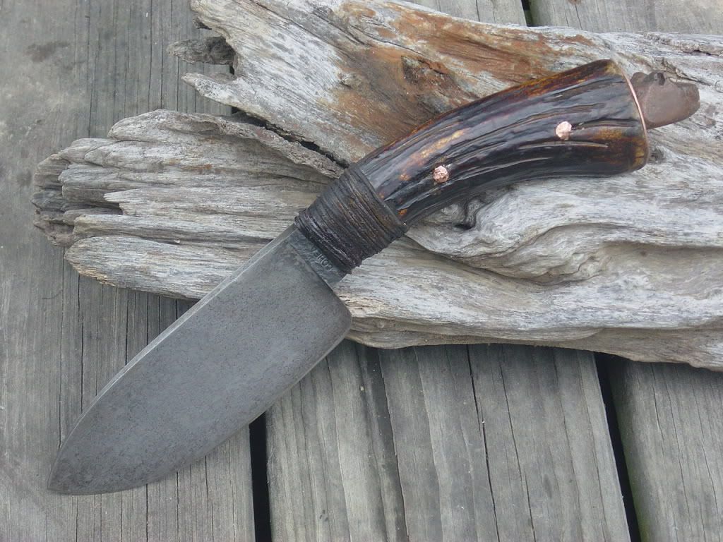

This was a custom order that was made for a fellow forum member, and something a bit different for me.

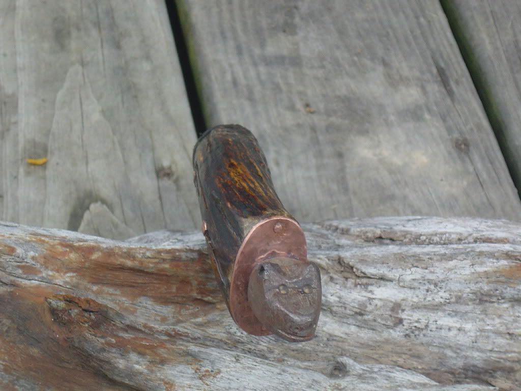

When Jason first contacted me about building this piece, he sent me a few pics of things he wanted in particular. One pic was the preffered blade style, and the other was a pic of an Inuit style animal head carving that he wanted made from metal on the butt of the knife. Here is the resulting piece.
It has a 6" long by 2" wide and almost 3/8" thick blade forged from leaf spring steel with a hard edge and soft back, and an antique finish. The handle is deer antler with a thin hammered copper butt plate with the crude animal head carving made from wrought iron with a copper wash.OAL is 12" including the animal head carving. Copper tacks and rawhide bolster wrap finish the piece off.

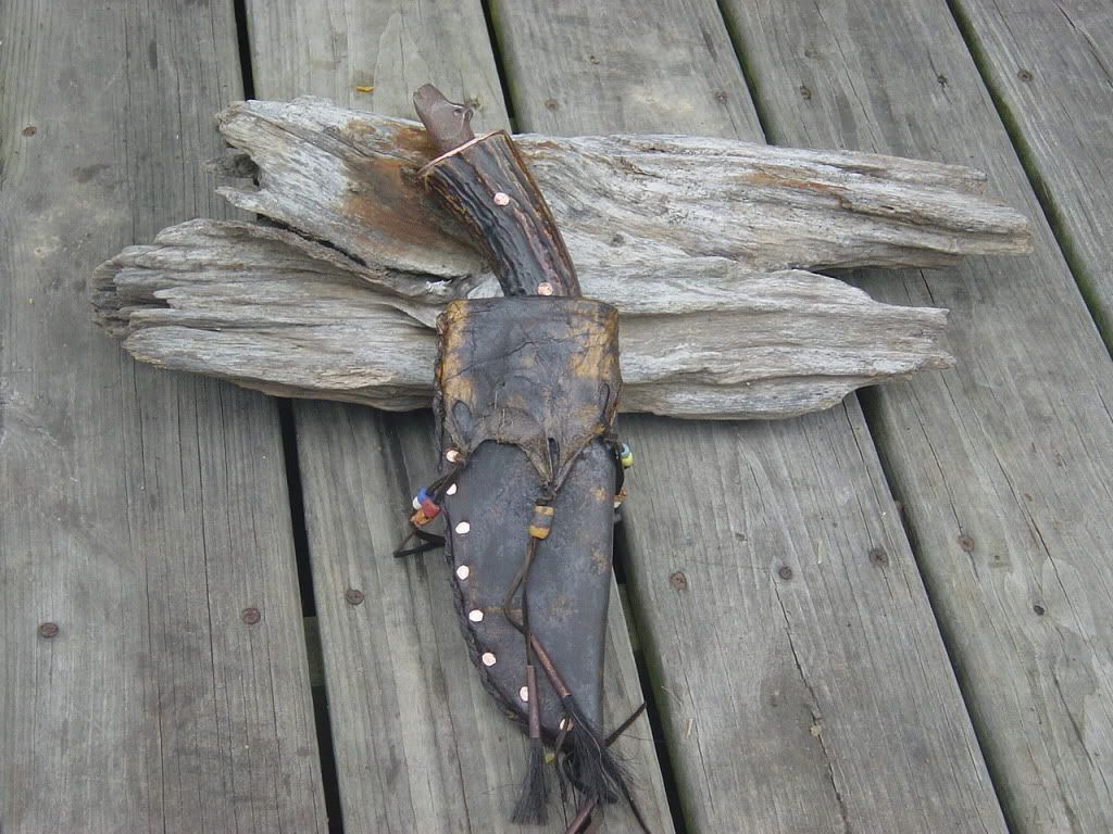

The sheath is rawhide over veg-tan, and has copper tacks, deerskin fringe,tin cones, antique trade beads, and snake vertabrae.
