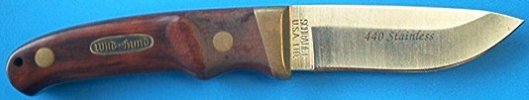

I am assuming you are referring to all the various PH1 and PH2 knives popping up on ebay. And there are some fascinating ones. The only PH I have seen made from 440 was this one, a special issue made for what we decided was a German hunting magazine: 'wild un hund' . See pic below.
