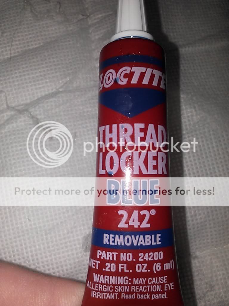

Hey guys! I got a tan skyline for christmas, and I love it. However, last week, I noticed that the main pin had, in fact, loosened to the point that it had fallen out of the knife. It's been loose before, and then I tighten it, but never this loose. If I tighten it too much, the knife obviously doesn't open very well. Thoughts? Suggestions? Thanks for your help!

Get some of this
It's blue loctite. It's a threadlocker. Pretty self explanatory actually.
Apply it to the screw's threads, or the threads in the handle, let it cure, and then you should be good.
I'd pick you're self up some blue lock tight for the pivot screw (make sure it's the blue kind) just dab a little on the screw tighten it so that it flips well and let it sit over night and problem solved!!
Just for maximum efficacy, clean any lube or gunk off the screw threads before applying the Loctite.
