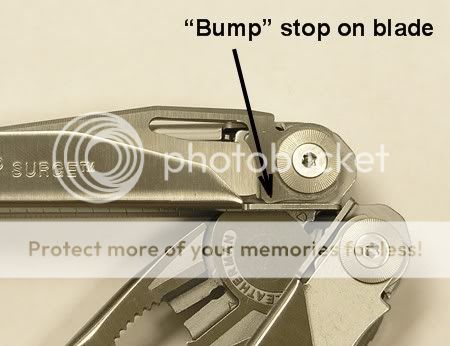

Like you, I have the leather sheath it came with, though I carry it vertical, i have wide belts and they can't seem to slide as easily into the sheath in a vertical position. Again, unlike you, the clip-point knife on mine does not touch the inside of the handle, what I noticed is that there is a small bump (near where the blade is secured into the handles with the torx screw) which prevents that from ever happening, unless I really push down on the top-side of the blade.

2. Your clip-point knife could possibly be missing or has a smaller "bump" than standard near the torx screw that I mentioned before, In which case you might wanna have the LM people take a look at it. They'll fix it up real good as they have a very reliable warranty policy.

Anyway, I also noticed the "bump", but the bump on my Surge does NOT touch the handle base to "stop" the knife. If I put moderate pressure on top of the closed blade, I can feel the blade edge bottoming out.

Anyway, going back to your original concern, if the little bump on the blade base is not enough to prohibit the cutting edge of the blade from touching the inside handle then it could be your blade may need some replacing, why not try going to your nearest Walmart, Costo or Target store, see if they have a Surge in stock and compare yours with what they have. See if the bump is as present or as big in their multi-tool as it is in yours, If they don't match in terms of size, then you got a defective product and it's best to have it replaced.

So you've got a black oxide Leatherman Surge, and the clip point knife is "bottoming out" in the handle channel, dulling the blade? Weird. I checked my Surge (see picture below) and the little bump-stop that sparkee is referring to works just like it is supposed to; the sharp part of the knife touches nothing but air.
Hmmm, it seems like if the blade portion on your tool is hitting the bottom of the channel, it would leave a shiny spot down there in the black oxide coating. Yes?
