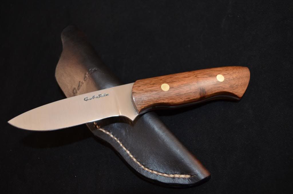

I had the same issue when I did my first couple and I am still learning how to do it but....
It seemed if i washed it and took to to the grinder/buffer right away to clean it up and put a final finish on it, the buffer and grinder would remove the black mark and leave no contrast.
I usually do for about 1.5 to 2 minutes of actual etch and mark times, but I lift up every 3 seconds or so. Sort of like a 1,2,3 Mississippi, lift, 4,5,6 Mississippi, lift, etc. So whatever time 90 Mississippi ends up being :) I don't count during the pauses.
I usually just go to the sink and use dish soap (it is also a base, just not as strong) and wash the etchant (sea-salt and water) off of the knife, then I let it sit for a while before doing anything.

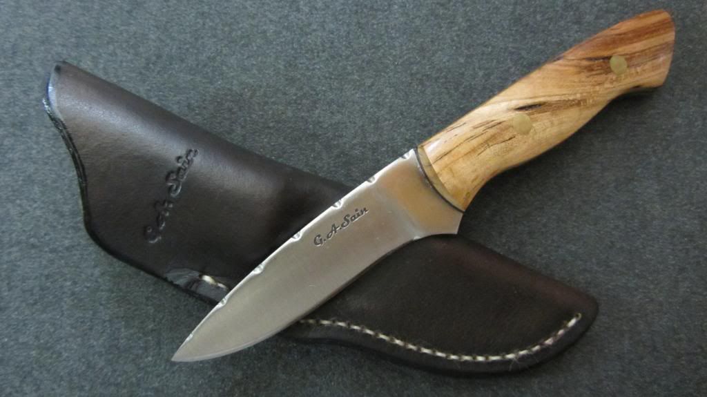

As you can see, I get ok marks with my totally redneck marking system (two power supplies (AC and DC) from who knows where with alligator clips, salt water and a wood block with make up pads and rubber bands)
Also, these are 1084.
