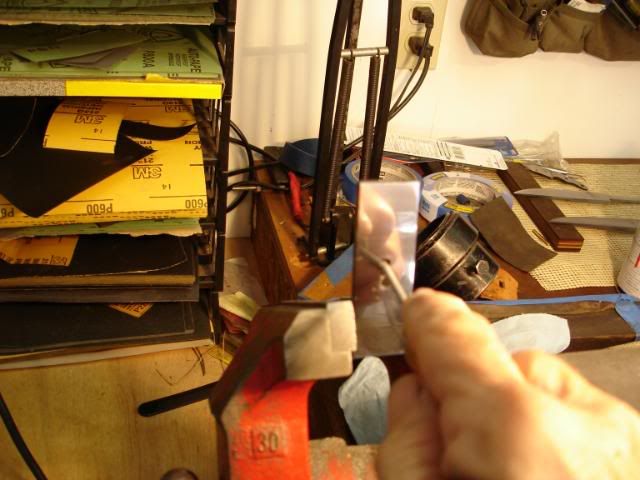

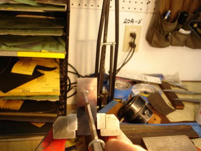

After drilling holes vertically in the damascus plate, connecting them with a round file.
Mirror polishing the guard plate shows when the file is "square" to the hole as the slot is filed for a press fit.

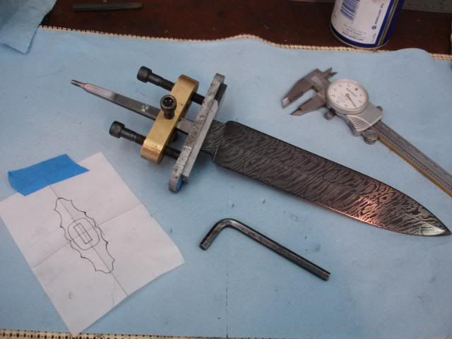

The slotted plate is trial press-fit to the blade, and a paper pattern is ready
The pattern is cut into the plate with a razor knife, and the shape is started on the grinder.

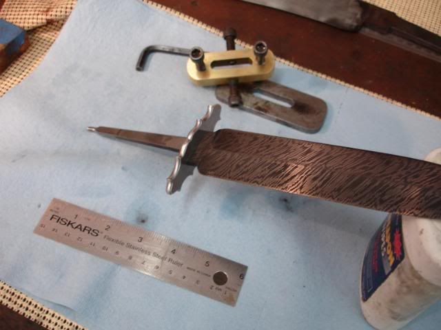

The shaped and sanded guard is trial fit to the blade.

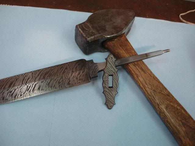

Etched, the shaped Damascus guard is ready to go. All the Damascus, blade, guard, collar, backstraps, and butt-cap are from a 4-bar,W,basket-weave, twist billet.
