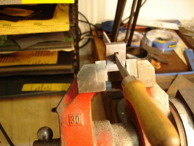

Slot is filed in collar material, fit is not so critical as guard, but still not loose.

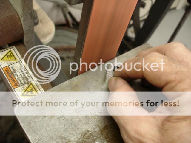

Slotted collar is ground to height and width, and rounded on work plate of grinder.

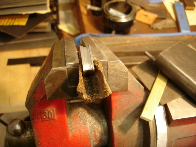

Using chain-saw file, collar is grooved to shoulder slots.

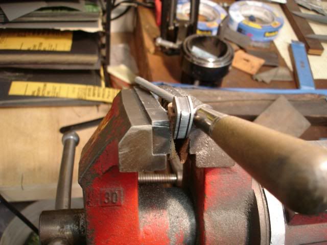

Collar is filed and sanded.

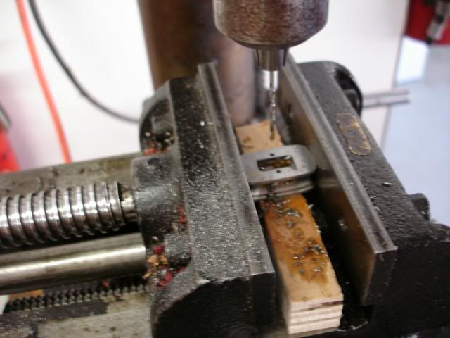

Holes are drilled for 1/16th" pins which will go through collar,two file-worked nickel-silver spacers, and into the ivory handle scales, so that everything will line up throughout the assembly and dis-assembly of finishing.

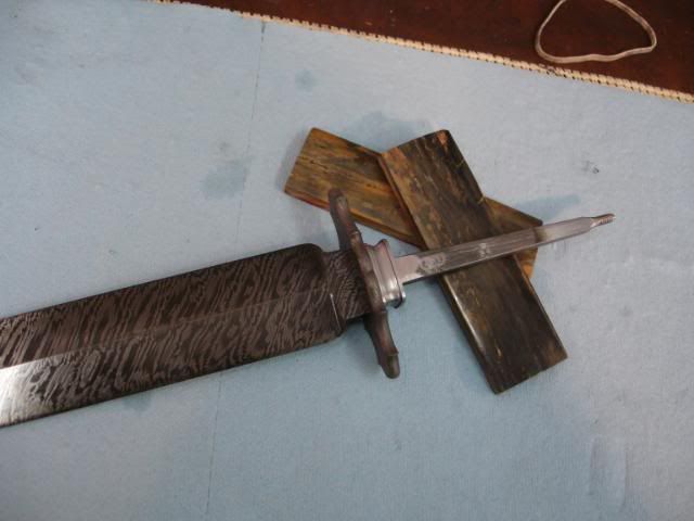

Finished collar. Only TWENTY TWO more pieces to go. Don't worry, I ran out of energy to take any more photos.
Look at bgspecialk's Number Three for 2008 for finished Dagger.
