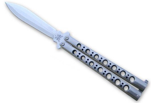

Benchmade model 46 (not your typical folder but a folder nonetheless)
