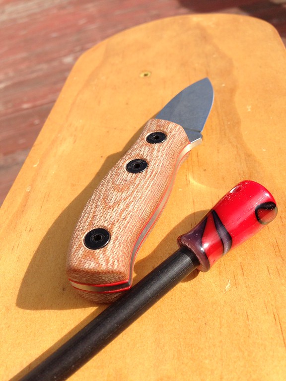

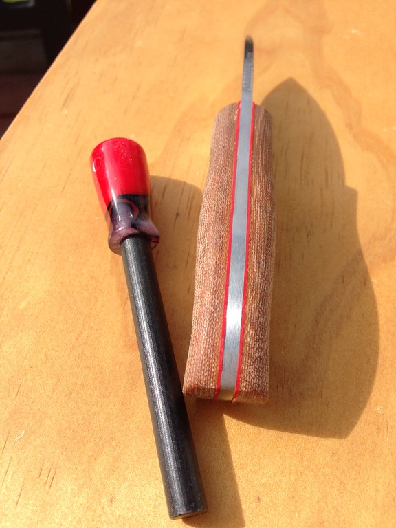

I decided that the Runt needs liners. And knowing that red is the most sought after color, I set out this morning to make the Production Runt my own. This time around I used poly file card liners from Walmart.
I then drilled the holes where the pins go and put the liners in place (oversized about 1/4 inch) tightening up the pins
Then I took a sharp knife and trimmed the liners to fit. This left a white hue to the cut edge.
To get rid of this, I fired up my MAP torch and hit it with a LITTLE heat. I probably need to trim a little closer in a few spots, but I figured it was always easier to trim later than to start over....
Hope this gives you guys some ideas.
BTW, it matches my red acrylic striker nicely.
Now on to the Hiking Buddy...

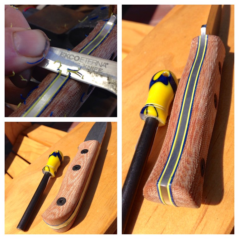

Just finished up the Hiking Buddy with a Blue and Gold liner in a nod to the Boy Scout roots of this knife (O.K. Cub scouts) Anyway, here are two pictures that pretty much show the process.
Again, hope this helps you guys get over the fear of tearing into a knife and making it yours.
Thanks for pictures and the caliper one. Perfect size for a liner. I like the cub scout nod. Put some wheels on that Runt and enter it in the Pinewood Derby!
