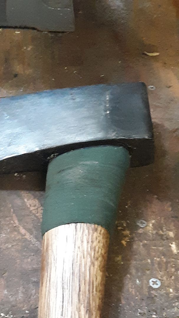

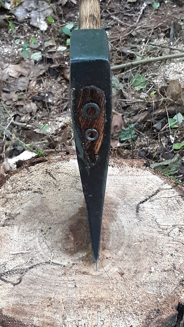

This past Saturday I went head hunting at a large flea market and picked up a promising splitter axe head. It has a quickly widening profile with a raised center and a slightly thinned poll behind the eye. I looked at the head I thought this ought to be good. The widening profile along with a higher center should facilitate extraction when penetrating. Additionally the thinned poll would allow the wider eye to work as a pivot point for extraction for easier extraction.

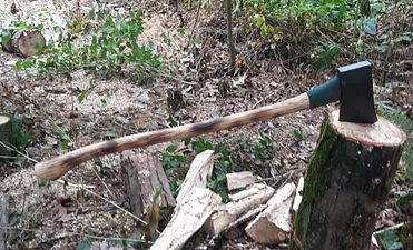

I put a 36" handle on it Saturday, fire treating to raise the grain and increase handle grip, and then profiled the head. I have a thicker (but sharp) cutting edge. I then thinned out the poll even more to ensure that the high center pivot point would transfer to the thicker eye pivot point without dragging on the poll on a deeper split that didn't completely separate the wood. It handles splitting dry wood with ease.
Today I further tested it by cutting up a wet log and splitting it. I was very pleased. Here's some pics.
Wide profile
Thinned Poll
My new splitter
