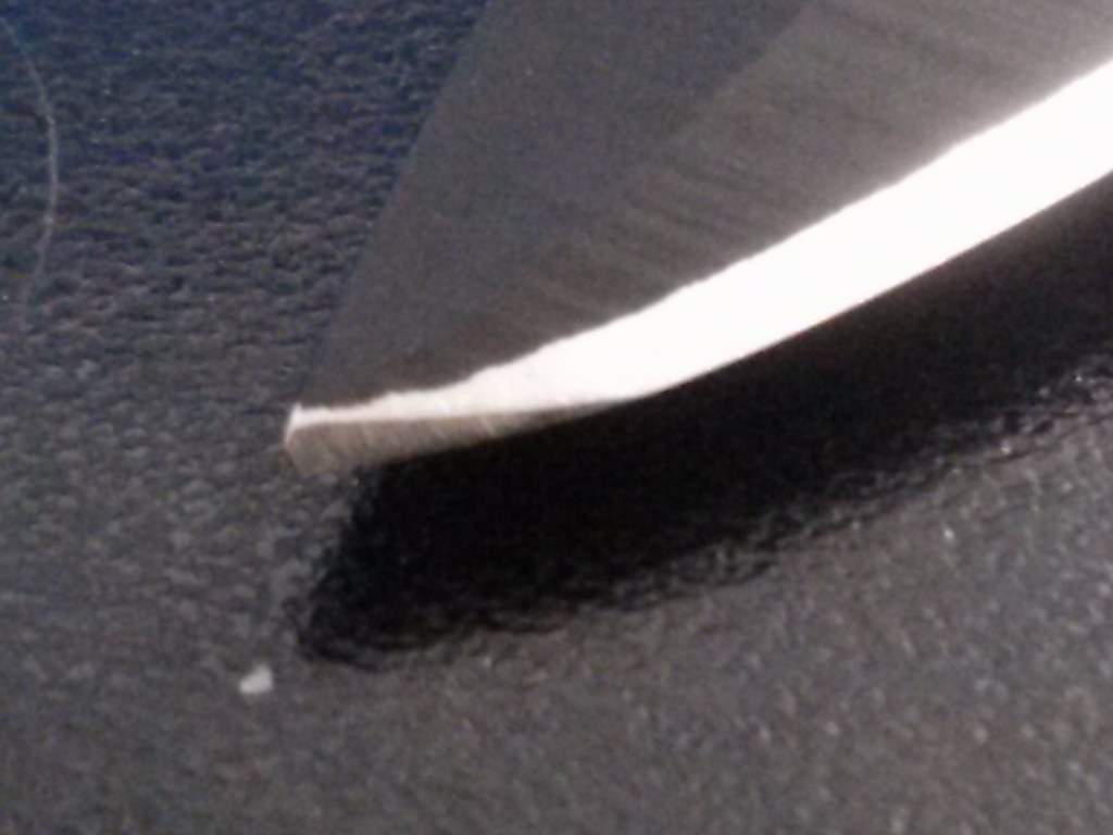

When I profile a blade with my Jet 10" wet sharpener, I cannot seem to figure out the correct movement of the tip of the blade.
My tip is always jacked up.

I have watched every video I can find, and it still messes up the tip. I will get a photo. (hate photographing failures lol)

I think this is a remnant from the original factory edge? Or is this something I created?
Whatever it is, I cannot accept this.

You aren't getting the whole edge off when grinding. You just need to work on the tip more. Sadly, since most knives are hand sharpened, most of the tips are rather obtuse because of how most people sharpen. It looks like your tip is like 5° or more obtuse than the rest of the edge.
First, you will have better results working from the horizontal rest with the wheel moving away from the knife edge. The finish will be finer also, as the cut isn't quite as aggressive with the wheel turning away. In the picture attached you can see that the problem gets started back away from the tip by what looks like 3/4". See the scalloping getting started? If the direction of the scratch marks move around the curve towards the very tip, you are swinging the handle of the knife to make the curve instead of raising it straight up. Two things that I believe will help. 1.) Move the tool rest to the horizontal position. Set a knife up as you normally would in the jig. 2.) With the machine off, move through the grinding pass. When you are getting into the curve, begin to raise the handle of the knife so the curve stays in contact with the wheel. Keep moving and raising until you're up to the tip. Be sure that you keep the plastic knob tight against the bar, and the jig at 90 degrees to the bar. Don't swing the jig to make the curve. If you do a couple of dry runs you will soon see how this works. When it is done correctly the scratch pattern at the tip will be going the same direction from butt to tip. Sorry to mention the Tormek knife video again but, the section in the video that addresses the point of the knife isn't very long. It's easy to miss. But if you see it, this will all become crystal clear to you. Good luck.
