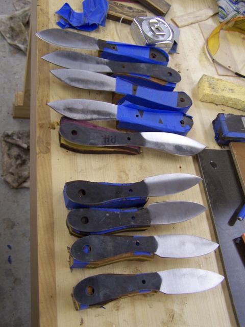

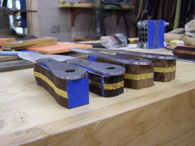

Here are some progress pics for y'all. We did some car camping up in the N. Ga mountains this weekend, but then it was back into the shop!

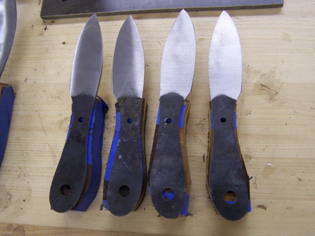

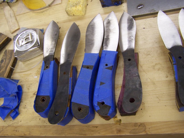

Thanks guys. THought you'd like to see some of the process. The handles are drilled and the bolster end is shaped here.

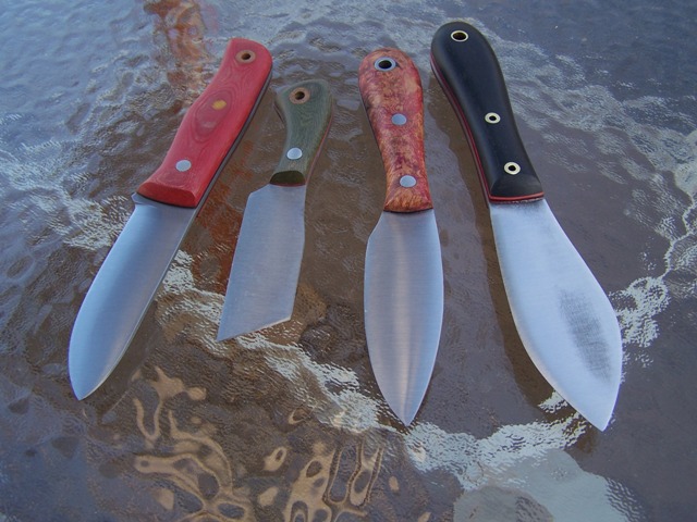

I really dig your EDC's those 4 on the bottom look great. I got mine on my belt right now.
That Nessmuck in the Purple heart wood is going to look great, you lining it with Osage?

Thanks! Haven't even gotten the mikarta and G-10 lined yet for the Bushcrafter Jr's. Dreading working that material. Wood is always great to work.

What are these? :)
What do you call them.

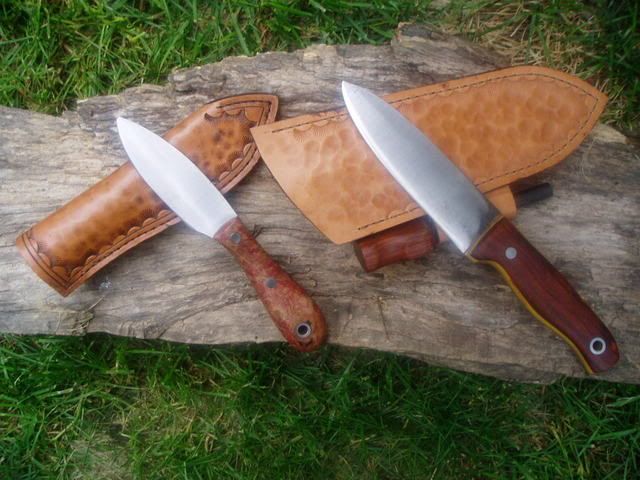

Do you have a picture of a finished one?
Those are my EDC model. They're made from 1/8" thick 01 steel. The front pin is a SS corby bolt and the rear on this set is going to be a 1/4" SS tube. They're laminated woods with Osage on the inside and Goncalo Alves (x2), East Indian Rosewood, and African Blackwood as the outter layer.

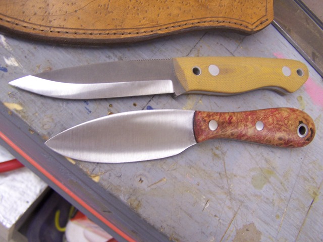

Here are some pics of the original model that Tony has.
And here it is with my Koster Bushcraft for size comp.
