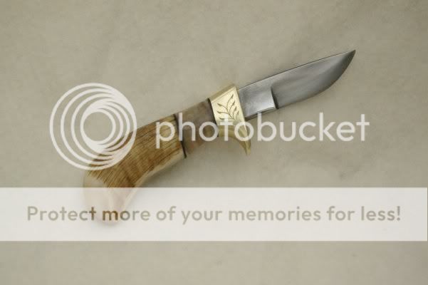

Some photos of Ed Fowler's knives i have owned or borrowed photos. I continue to find these personally the most interesting of all handmade knives. The forms are a thing of beauty to me- they say user-friendly, distinctive, and "pocket worn". A very uncomplicated, natural style. I love it!
If others have similar knives please share..

I like his knives for the blade shape mostly. I can appreciate the handles, but its not my cup of tea. Certainly distictive.

Not a criticism in any way, they are well made knives for sure. Why is the Ricasso so large? Thanks for sharing.
Ryan,
Thanks for the interest. The spine and lower portion of ricasso and top edges of guard are all rounded to allow more comfort in a variety of holds. The long ricasso is a finger rest. In such a grip it allows a larger knife to be used as a smaller; more leverage. (from "Knife Talk")
This might look scary initially but i assure you it is very safe in detailed cutting tasks. I have used just the top 1" of this knife doing several small wood carvings.

RyanW - I certainly don't speak for Ed and have no comment on his particular design choice here, but I have heard it suggested in general that a large ricasso on hunting knives allows you to "choke up" on the blade and get your hand closer to the cutting edge for better "control". I have seen that suggestion countered by pointing out that eliminating the large ricasso would accomplish the same goal - effectively bringing your hand closer to the cutting edge while keeping it safely behind the guard. Of course, all that begs the question of how difficult it is to "control" a 4" blade while dressing game. I haven't found it to be particularly difficult. But that's the nice thing about custom knives - lots of selection and many great makers who can supply a knife with design features that appeal to you. Those who value a huge ricasso get to have it their way just the same as those who don't.

Thanks for the explanation on the ricasso. I make some knives with a large half circle choil for the same reason, being able to choke up on a knife makes a huge difference in control.
Edit: Sorry Roger didn't see your post, I have found a guarded knife a bit difficult to get my fingers round the guard comfortably
Thanks Ryan. Roger, you have a good point. As you say, let your experiences dictate ones preferences. One thing i would say, using a knife with the choked up grip the guard should be substantial- a Loveless type guard would be too small to provide the same adequate amount of support- my own personal opinion.

I don't own mine anymore, but I'm still a big fan of Eds work. I need to add some to the collection again when the right time comes. They melt into the hand and are super strong, in my opinion.
That "camp" knife is VERY nice.

Just wondering, how many of you see Ed's handles as "basically the same on every knife"? I have always thought them to be highly individualistic in feel, one from another. Others see it differently. Let me know what you think.,
Thanks,
David
While I don't consider every one of Ed's handles to be the same, I DO see them as all of the same STYLE. There is nothing wrong with that, as the old cliche goes "if it ain't broke....". Sheep horn being a natural material like stag, no two pieces are the same.
In handling several of Ed's knives, each one felt VERY different and placed the blade in a way to perform various functions, as Ed no doubt intended.
