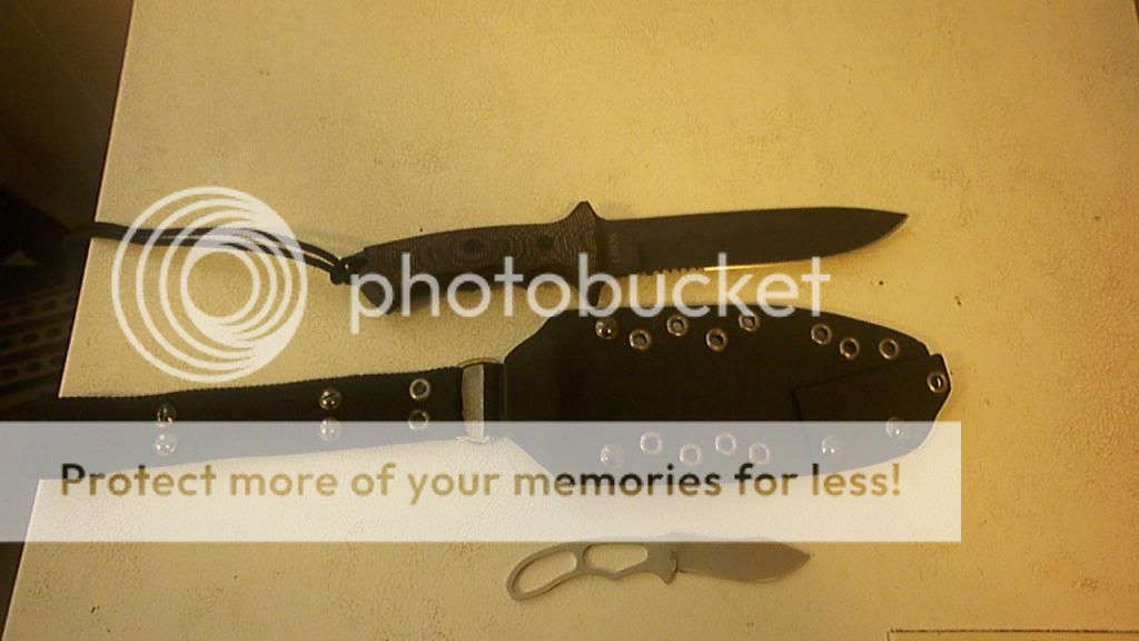

Worked out ok, except the first eyelets I didn't put close enough to the blade hence the staggered rivets.
