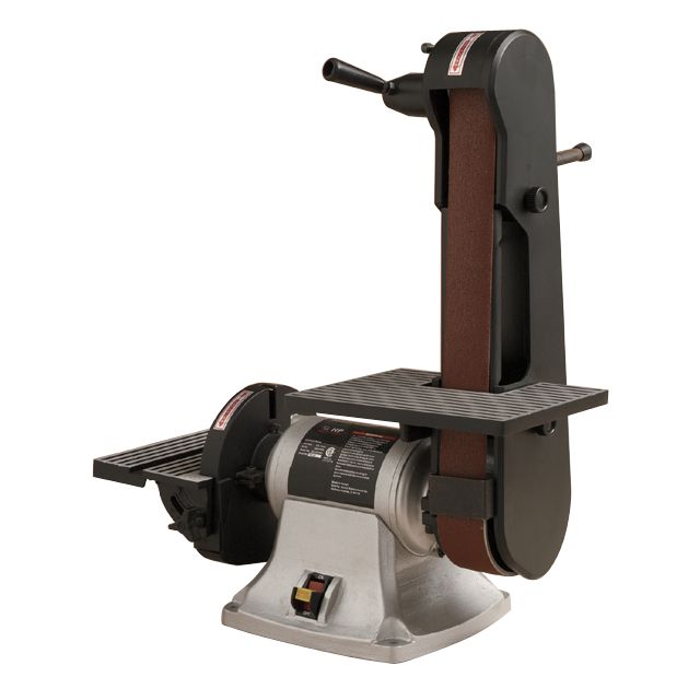

I use one of these when necessary, a Craftsman 2x42" belt grinder -

Crazyotter, it's quite possible to do some very fine sharpening on a belt grinder, even on small knives. One does have to be careful to avoid too much pressure and heat. I normally use the grinder to reform bevels, remove nicks, or reprofile. I do use a grinder on large knives which would take too long to sharpen on a stone or otherwise.

I believe you, I'm just horrible with power tools. Truth be told, I had to send my leatherman wave away to be re profiled after I tried power tooling the blade. Maybe sometime I'll try it again, but I think it would be best if I practiced angles first...
