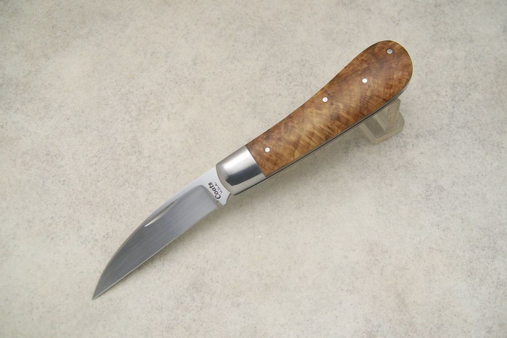

That first piece is beautiful. I would bet you can stabilize it and it will be wonderful.
Randy
Looks beautiful. Looks like Australian Buloke (which makes obvious sense). I bet it'll be great!

Don, that is a really nice handle. I love that grain.

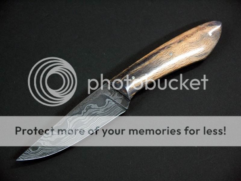

You can load it up with numerous coats of super glue and take care of the pores, here's some
oak on one I just finished.

Nice knife Ken. Is that some kind of specialty knife? It looks like it might be designed for a specific purpose.
Are you saying you use CA glue instead of stabilizing, just to fill the pores?
